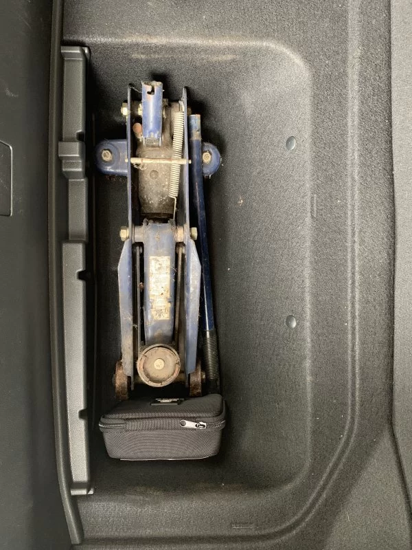

First it will fit nicely in the lower well in the trunk! Perfect for a trip. First aid kit left for size perspective.

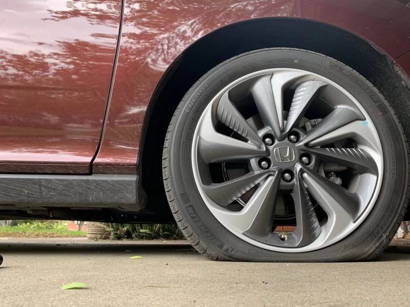

OK, then. Let's see if it will work on a flat front tire. So, I let all the air out for realistic simulation.

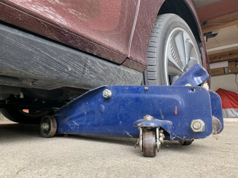

Next, is there enough clearance? Yup, close but no problemo'.

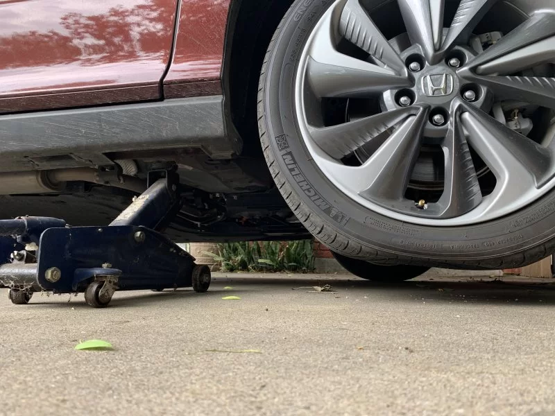

No issues with lifting the big girl either. Approx. 20-25 pumps.
