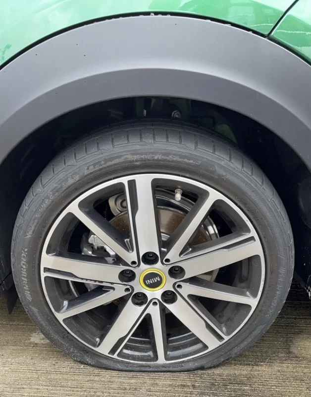

To cut right to it: my first use of the Mini roadside service was great! I'm just sorry I had to use them. Flatbed tow to my Mini dealer successful. And I wish the SE had a small spare tire and jack so that I could have simply handled it myself.
The Scene: New Years Eve, heavy rain, and I was not with my Mini SE. It was being driven by someone else. My wife and I were driving in a separate car to the same location - a live theater show (80s rock songs) for New Years Eve. The unnamed driver of my SE curbed the Mini in the heavy downpour in the dark right near the theater. They drove it slowly into a nearby parking space as the low tire pressure warning popped up after the impact.
I arrived at the theater lobby a short while later to find the upset and shaking driver, who was very nervous about how I would react. I smiled and told them three times in five minutes that stuff happens, and NOT to worry about the accident. I didn't even go and look at the Mini before the show started.
We had a great time at the show and rung in 2022 with live music and friends and family (and masks)! Then I went and checked on the car. No visible rim damage in the darkness (whew!), but I could not find where the hole was. Since it was 12:30 AM, and the Mini was parked in a VERY safe area, I left it and went home.
First thing the next morning I went back to the Mini. The wheel was perfect - no curb rash. There was a half inch hole in the tire sidewall right next to the wheel rim. I started the Mini and it immediately prompted me with the critical flat warning and a prompt to call roadside. My experience with the operator was great - they contacted the towing service (I verified twice that the service would send a flatbed).
The roadside operator said that my Mini dealer was closed for New Years, but that I could have the Mini towed to my house, and then get it towed a second time to the Mini dealer at no charge. I said that would be great.
Within 30 minutes the flatbed arrived. The driver told me that he just finished towing a BMW to my Mini/BMW dealer and that service was open for a few more hours - so we agreed he would just transport it straight to the dealer. He evaluated the flat tire and showed me how the collapsed tire was still in place and had a protective rim of rubber preventing the wheel from touching the pavement. He told me this to reassure me as he proceeded to slowly drive the Mini the short distance to the ramp of the flatbed.
So my Mini was towed to the dealer, and today I wait for them to call me about getting a new tire or two. My tires have 6,500 miles on them, so I'm not sure if I will be buying one new tire or two.

That's what the tire goo that comes with the SE is for, or run flats. MINI doesn't do spare tires anymore, I don't believe. And thankfully most everyone has gotten away from those dangerous mini spares.
The tire goo may not have helped with your particular damage, but run flats would certainly have allowed driving it to the dealer. I've always used run flats on my ICE MINIs, but the greater noise and lower efficiency may not be ideal for the SE.

I’m not really sure why anyone in an electric car would be more likely to want to be stranded along the road with a flat tire. I don’t really understand the BMW logic by not including run flat tires on the SE or at least making them an option.
My first mod was upgrading my SE’s tires to Pirelli P1 run flats. I have approx 5K miles on the tires and have not observed any appreciable degradation of range.
And I'm still waiting for the service department to get back to me after several messages left with different people. I can't get anyone on the phone. For one flat tire. I will be considering run flats in the future.
So they had to order a tire for me - supposed to come tomorrow by 5 PM. At least three business days to get a flat tire replaced by Mini (plus the full weekend, but I wasn't counting that against them). It's a good thing I had other cars available to me. I like roadside service. Mini dealer service, not so much.
The theory is that reducing unsprung weight will increase the range, but I don't know how well that holds up to reality.
I wanted run-flats for my winter tires but tires are so hard to find right now that I ended up going with conventional tires. A lot of people complain endlessly about the harsh ride of run-flats, but they've never bothered me personally.

I had a relatively good experience using the tire puncture kit that is included with our Mini's. I was the lucky recipient of a 4 inch wood screw in the drivers rear tire. Did not get the tire pressure warning until I got home. Proceeded to pull the screw out and follow the instructions in the manual. Quick tip to get the sealant the fill the puncture.
Position the puncture so its positioned toward the road/ground that way the sealant will collect toward at the bottom of the tire toward the puncture. I still had to drive back in forth a few feet to distribute the sealant in the tire but the sealant quickly stopped the leak. The compressor that is included in the kit is actually really powerful.
