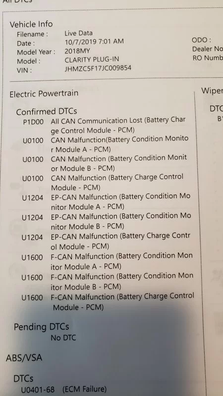

Attached is a picture of the primary codes, but there was also others for things like Windshield wipers, brake, and ECM failure.
