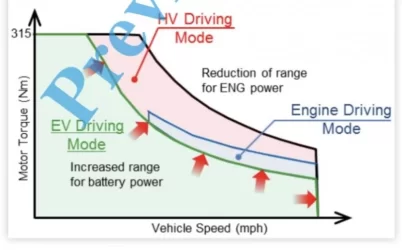

I have felt that way many times... That was when I started doing the 'HV reset': Just switch to EV mode for 2 seconds by pushing the HV button twice, slowly. This puts the drive back to engine drive mode, and reduces the engine RPM. You need to have some battery capacity available to do this.
For me, the noise is higher when the ignition timing gets a little out of whack. For the first 70K miles of my driving, it was consistently noisy at high engine RPM. I used some 90 octane fuel, this seemed to jump the timing, and the noise has been much better even when I use 87 octane. I still get an occasional drive with high noise. Last time it happened, the timing was over 30. (It normally runs 8-20)
This is the first time someone has described a way to force the Clarity PHEV into Engine Drive Mode.
In my experience, you have to coddle the car at speeds greater than 45 mph to achieve Engine Drive Mode--then any significant pressure on the accelerator takes it out of Engine Drive Mode.
But you are able to take your Clarity out of HV for 2 seconds, then re-engage HV and your Clarity will immediately switch on Engine Drive Mode? Is Engine Drive Mode engaged this way any more willing to accept hill-duty?
I think it may be likely that once the engine can rely more on the battery (after resetting the battery level 'setpoint'), the power output required (RPM) from the engine lessens and the car can go back into Engine drive mode (gear illuminated on center screen). It's an interesting idea. I'll certainly be more likely in cold weather and hilly drives to hold all of my battery at the start of the drive (I usually hold a little more than half) so that this technique can be used if RPM seems to be getting out of hand. It might also be a good use of the battery to improve overall efficiency.
I know that I have discussed this previously... Maybe you were not involved in the conversation.
I do an HV reset, and the car goes back into gear drive mode.
That was 7/20/20
It is resetting the HV mode set point, but when you are over 45 mph, the car will go into engine drive mode. I would say that it goes to engine drive mode 100% of the time. (When starting with RPM over synchronous speed.)
Most of my driving is at 78 mph on interstates, so I have a lot of experience with hills and high rpm's.

F76E02A8-536E-4720-9AF2-08C5BF38D686.webp Can anyone demonstrate that the Clarity will remain in EDM outside of the range of operation shown above, regardless of the method used to engaged EDM?
