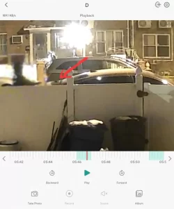

So, My Clarity got broken into the other day. Does any1 know, can the Clarity be easily hacked? My security cameras showed the perp opened the car as if he has a remote of some sort. Also, the perp left something on the top of the rear trunk and the 1st thing he did was retrieve the item(maybe remote jammer) then opened the trunk.
2 video clips from 2 different camera angles + screenshot of the item the perp retrieved from the trunk

Strangely enough he didn't even take the L2 charger nor airbags. He did ransack the car. Footages showed that it was quick in and out, haha like the burger joint.

Let's hope the Clarity has rolling codes implanted. From what I can see either the car was unlocked or the perp's has the keycodes itself. He opened the car as if he has my keyfob.

The keyfob is pretty far away from the car. It's impossible to unlock it from the distant where the keyfob's location. Unless the perp was waiting for me to unlock and copying the keycode.
