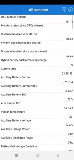

Woke up to a dead 12 Volt battery for the 2nd time in 3 weeks. I do have a small Li-Ion EV jump start battery, so I was able to start the car.. I'm not sure if it's the battery itself as when it went dead 3 weeks ago, I was able to get it to 87% SoC and when I checked a few times in the morning after that, it was still 86 to 87%.. Today, I jumped it again and drove for 1.5 hours.. SoC of the 12V battery is now at under 30%. I believe that something is draining it on some nights.. Will have to bring the car to Hyundai on Monday to check what's going on..
After some discussion on a facebook Kona group, it appears that it may have something to do with my OBD2 dongle which I often leave plugged in all night long...
My 12 Volt seems to be past it's useful life as it shows 27% SoC right now after driving 150 miles today...
