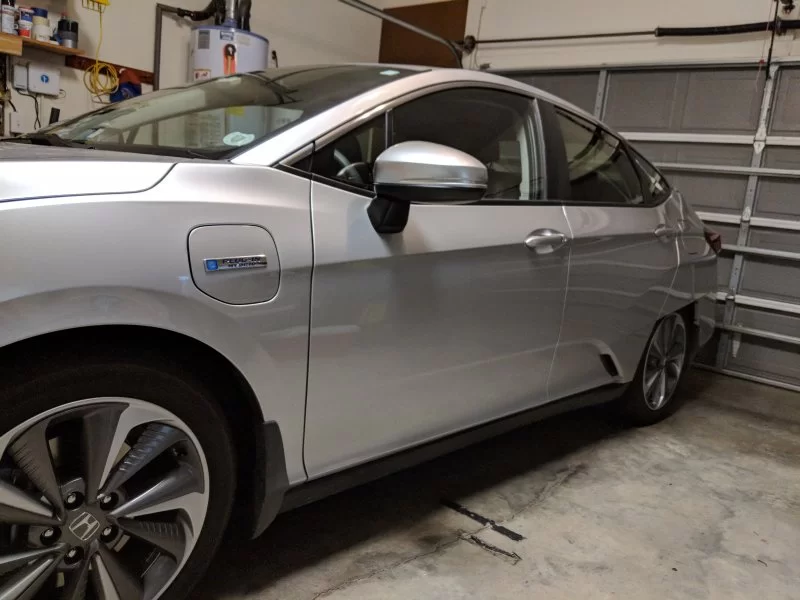

Here you go. I installed them myself. It isn't as scary as the instructions lead you to believe. Just need to use a bit of care. The front ones are pretty easy. The rear ones are more difficult, and a bit uncomfortable to install, but I'm 78, and working on my hands and knees is more difficult than it used to be.
I strongly suggest having a small ratcheting right-angle philips-head screwdriver available, as the rear tires are very close to the screws. There was an earlier thread in which I and others discussed details of the installation process. The mud guards were an excellent investment. I hated the way mud and water sprayed up on the doors and the rear area prior to installing them. It has very much minimized that annoyance.
I really don't think that they have affected mileage in any significant way. I'm still getting upwards of 55 miles per full charge on a moderate temperature day.

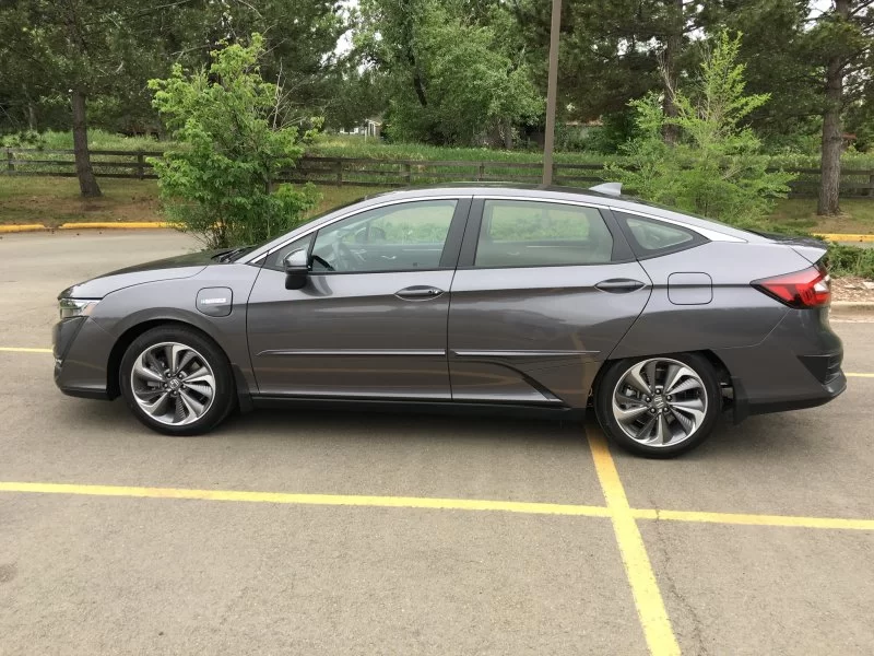

Anybody have a grey Clarity with their mudflaps installed? I got mine but haven't put it on yet. ImI curious to see a photo!
We had the dealer install them, so I can’t speak to ease of installation. But here is a side view of ours with the mud flaps installed. It isn’t a great picture-but should give you an idea. I find them pretty unobtrusive in terms of looks on the grey, as I imagine they would be on the black.
Thanks for the photo!I just got them installed today. I bought them at College Hills Honda with the intention of installing them myself. I kept putting it off so I had the dealer install it. I agree that it doesn't stand out much on the grey.. It's barely noticeable that I forgot to look at them before leaving the dealership.
