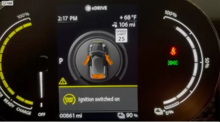

An icon came up on the instruCluster I hadn't seen before. It was a round green disc and said "mph."
Checked the manual, nada under green indicators.
Came on when I was on the open highway with CrCon set for the speed limit. Haven't seen it on the local freeway around town, but only ever on it for 10 mins max.
Was about where the yellow Warning icon is here, maybe a little lower. A little hard to snap a pic at 70mph, the speed limit on a lot of our highways.

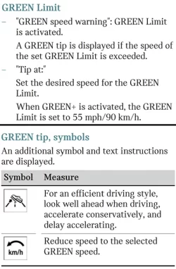

I believe @Puppethead has nailed it. These two pieces from page 215 of the Owners Manual I have online explain about the "Green Tip" symbols that can appear on your instrument panel when driving in Green or Green+ mode. The symbol shown is km/h, but I'm sure US cars must display the mph symbol.
You can also set it for non green modes. I have mine for 79 since I have a lead foot and our speed limit is 65 in most places. Reminds me to slow down.

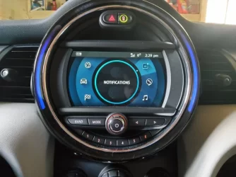

As an fyi if you go to the main menu and select the top right icon (can't recall if that's notifications or another) you can select that and get a read out of your warning notification. I'll attach a screen shot soon of where I am talking about in the next post.
That's it. Though it was a pretty round icon with a gradient green. Looked to me like Evvy was telling me I was doing something right. I recognize the curved arrow while it showed "mph." Kept wondering why it was telling me to go backwards.

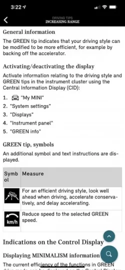

Thanks, mates! Here's the same page in the smartPhone app.
