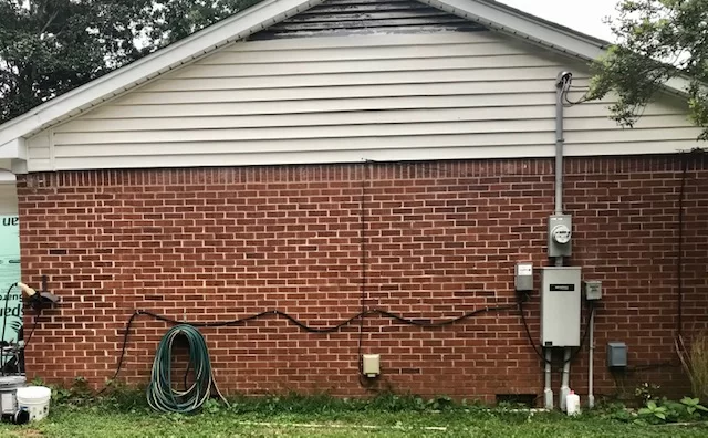

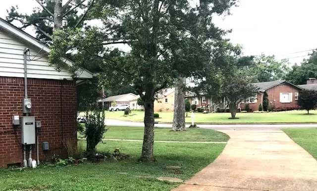

When we upgraded to 200 A service and an automatic, natural gas, generator, the 50 A circuit went to a NEMA 14-50 in an all weather box. Located to the right of automatic transfer switch, a water hose mount on the tree held the J1772 from the JuiceBox 40 Pro:
There was easy front door access but this is the narrow part of the driveway. Not shown but there is slope to the right which is not a good way to bypass a charging car.

Ordinarily, moving the NEMA 14-50 circuit would require a +$500 electrician or a permit and inspection of my work with the city. Instead, I relocated the EVSE to the left of the transfer switch and used mason bolts and tie-wraps to hold the J1772 cable run to the opposite corner:
Still, there was only 5-6 ft of slack which made a challenge.

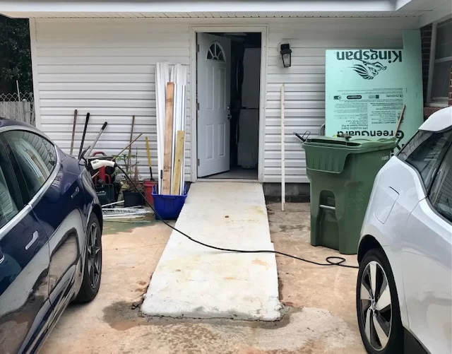

I modified the hose rack and installed my spare, 24 ft J1772 extension. Now both cars can park in the back and either be easily charged:
There is easy access to the laundry room ramp into the kitchen. This is enough for now although there is a potential trip hazard.
