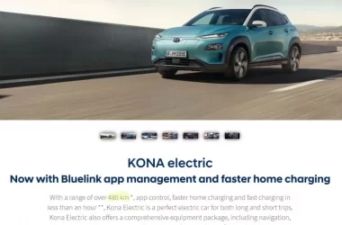

The information comes from Hyundai Norway:
With a range of over 480 km *, app control, faster home charging and fast charging in under an hour **, Kona Electric is a perfect electric car for both long and short trips. Kona Electric also offers a comprehensive equipment package, including navigation, premium KRELL sound systems and a complete safety package.
* The scope is based on WLTP applies to Kona Electric manufactured from March 2020, factory supplied with new Michelin Primacy 4 tires.
Previous models have the WLTP range stated at 449 km. The range may vary depending on the ground, your driving style and temperature.
** 0-80 percent charge in 54 minutes on a 100 kW charging station.

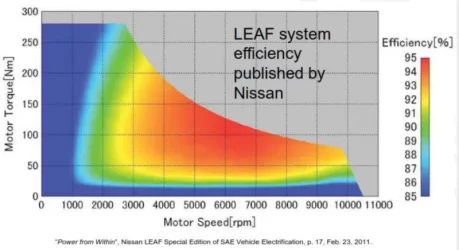

If there had been a better tyre for range Hyundai would have used it in the first place. There is no tyre group test that makes that sort of claim about Primacy 4’s. No conclusions can be drawn without seeing the full specs. A range increase could come entirely from easing the acceleration with a “taller” final drive ratio - back in the day they called it ‘overdrive’.
The Kona already has a 4% higher reduction ratio than the e-Niro yet the WLTP ranges are nearly identical with the same size battery.
Also, this graph of the (similarly permanent-magnet) Leaf motor efficiency indicates minimal change related directly to RPM, particularly at the mid range, which is about highway speeds.
Certainly the many peculiarities of ICE efficiencies can be well-exploited in those vehicles but there are less opportunities in an EV, although Porsche seems to have missed out on more than anyone.
