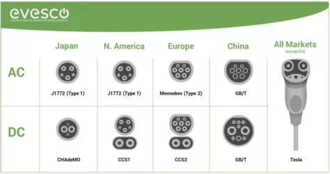

Much of the world outside of China and Japan already has a single standard and that is CCS Combo 2 (informally called CCS2), and that includes Tesla. For Tesla to open up their infrastructure to others takes merely the flick of a switch. Tesla drivers have always had access to all public CCS2 stations.
All this change to NACS will eventually do is finally provide a unified EV connector in N. America, 5% of the global population, but by way of corporate strength rather than regulation. Given Tesla's stance long ago of not making charging a profit center, I would imagine that their charging prices would now need to increase to match what it actually costs to profitably provide this service.
- not just Europe, Australia and New Zealand have also standardised on CCS2.

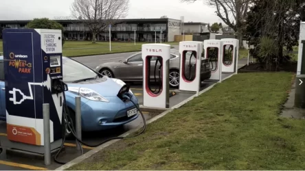

Here in New Zealand Tesla owners often use CCS Combo 2 chargers when they cost less.
The single CCS2 charger here is fixed at a very low NZ$0.40/kWh while the rates for the four Tesla SuperChargers are only revealed once you check with the app and will be a lot higher. Plus they apply idle fees after 5 min.
On the whole I try to be patient with Tesla drivers but it does get a bit trying when they are using the only fast charger available while there are Super chargers free a block away and I have to recharge for a three hundred km journey to the next charger. The excuse is always it's cheaper.

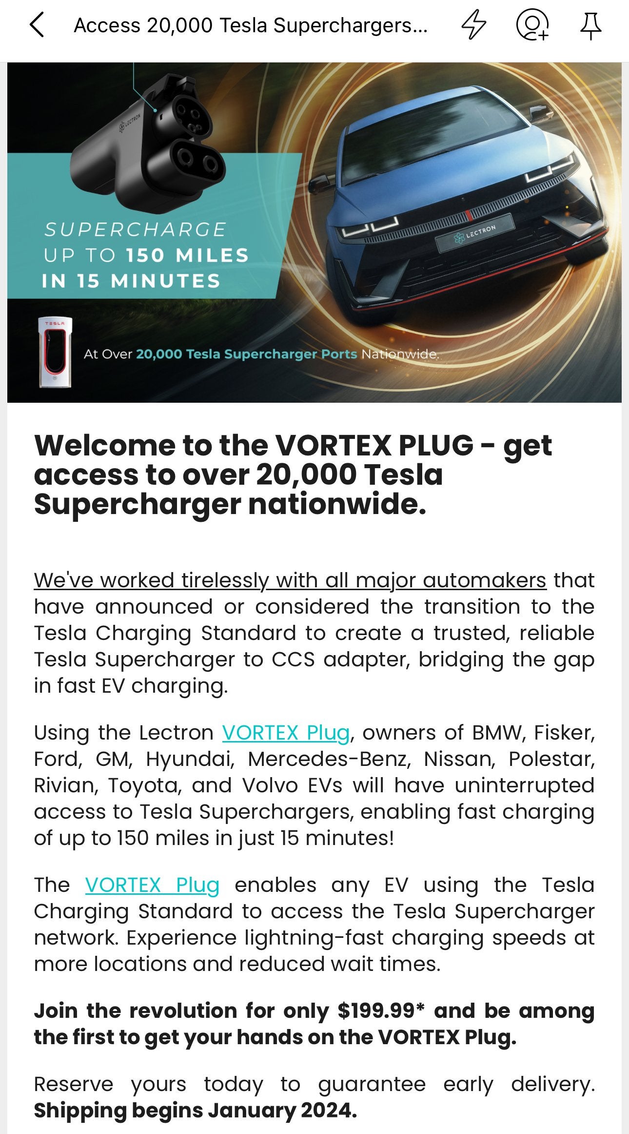

Lectron introduces some competition...$285 CDN
img_1203-jpeg.28937
I personally will not order, until certification approval and more specification details are provided. Possibly this is the reason for pre-order only until January 2024 delivery.
Also the A2Z website has been updated now shows price @ $270 CAD for the Typhoon variant.
Competition is a good thing, I suspect the winner will be who gets approval first and has the stock to provide sales:)
I agree. I will wait for certification and also reviews showing the adapter works well. I am in no rush to test the first one. While I would like the ability to charge at Superchargers I don't travel long distances enough to make it critical.
A good reason not to buy this Vortex plug adapter (at least until addressed by Lectron) as displayed in this video. Demonstrates the ability to withdraw the NACS portion while charging due to a fault in the locking mechanism:
I watched Tom Moloughney's review and it worked fine for him. Seems to me like an isolated case. Read in other forums that Lectron has reached out to those who expressed their concerns about this design flaw. Kudos to them for being quick on their feet
