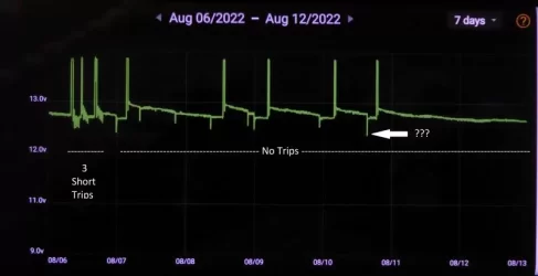

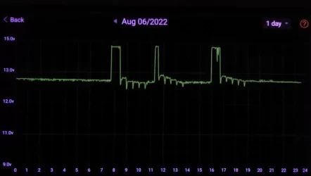

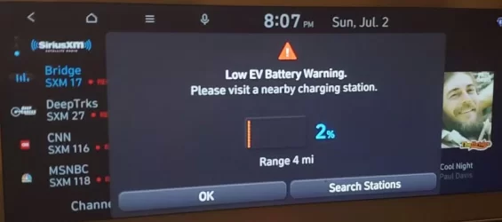

The car has been parked for about 9 days now, and so far, the 12-volt battery has not died. The first image shows the BM2 recording for the day of the trip. Just before the trip, I charged the traction battery enough to leave about 10% remaining after the trip. On the return trip, we ran into a major thunderstorm, and we had to detour off of I-65 and wait about 30 minutes. That meant that we just barely made it home with only three miles to spare. P1000319_cropLabeled.webp The second image shows the BM2 record over the next 9 days. The voltage gradually dropped from 12.62 to 12.5, but the 12-volt battery never died. P1000314_cropLabeled.webp There were three small negative spikes over the 9 days. The first was when I queried the status of the car. The second was when I opened the hatch the next day to unload some items, and the third I believe was when my wife opened the doors looking for a lost earring. The traction battery never tried to charge the 12-volt battery during the nine days, but the 12-volt battery voltage decreased so slowly that it never entered the vicious cycle I observed before. My assumption is that when they changed the ICCU to fix the separate slow charging problem, that also fixed the dead battery problem as well. It's not impressive that two different dealers on three different occasions never took my dead battery problem seriously, and if I had not subsequently had a separate problem, my guess is that they never would have fixed it.
I had previously criticized the apparent decision of the design engineers not to use the traction battery to recharge the 12-volt battery when the traction battery was below a certain value (probably about 20%). Now that it looks like the dead 12-volt batteries were the result of excessive drain, I am a little less critical of that design decision. Although I am now less critical of the design engineers, I am still very critical of the three service teams who refused to pay attention to the recordings I gave them and refused to even contact Hyundai to see if someone with more expertise might have a suggestion. Had they done so, I suspect that a competent engineer would have quickly seen that there really was a problem. And I am still critical of the Hyundai customer service people, who also refused to address the problem and just referred me back to the dealer, who had already demonstrated that they were not competent to diagnose the problem.
I'm looking forward to resuming use of the car, which I really love to drive. For the last 9 days, I have been driving my old Honda Element, which has been a great car with not a single mechanical problem. But my wife will still refuse to drive the Hyundai. She still calls it a lemon, and I can't really fault her for that.
The car has been parked for about 9 days now, and so far, the 12-volt battery has not died. The first image shows the BM2 recording for the day of the trip. Just before the trip, I charged the traction battery enough to leave about 10% remaining after the trip. On the return trip, we ran into a major thunderstorm, and we had to detour off of I-65 and wait about 30 minutes. That meant that we just barely made it home with only three miles to spare. View attachment 20939 The second image shows the BM2 record over the next 9 days. The voltage gradually dropped from 12.62 to 12.5, but the 12-volt battery never died. View attachment 20940 There were three small negative spikes over the 9 days. The first was when I queried the status of the car. The second was when I opened the hatch the next day to unload some items, and the third I believe was when my wife opened the doors looking for a lost earring. The traction battery never tried to charge the 12-volt battery during the nine days, but the 12-volt battery voltage decreased so slowly that it never entered the vicious cycle I observed before. My assumption is that when they changed the ICCU to fix the separate slow charging problem, that also fixed the dead battery problem as well. It's not impressive that two different dealers on three different occasions never took my dead battery problem seriously, and if I had not subsequently had a separate problem, my guess is that they never would have fixed it.

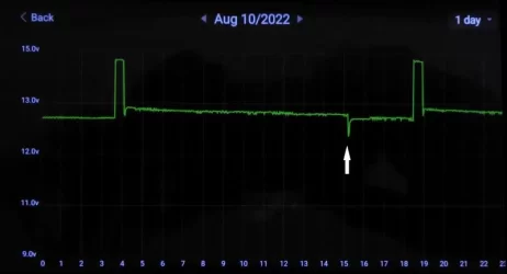

I want to report a positive outcome on the 12 volt batter parasitic drain problem on my Ioniq 5. The bottom line: the dealer replaced the AVN head unit and performed recall updates on the ICCU. This has completely changed the BM2 profiles. Previously there were 3-4 short duration voltage drops per hour that would eventually drain the 12v battery. In order to keep the battery charged I installed a "battery tender" (small battery charger) and tried to drive or charge the traction battery every day. After the repair/updates the short term voltage drops occur about twice/day instead of 3/hour. I left the car for 4 days without charging or driving and the battery went from 13.14 volts to 12.78 volts. So, I think the problem is resolved!
As an aside, it took about two months to get the new AVN head unit. During that time I contacted Hyundai Customer Support for help. After requesting for a lemon-law refund, the AVN head unit "magically" appeared at the dealer and was installed in about a day. I'm happy that the dealer was able to diagnose the problem correctly, but disappointed that I had to threaten legal action.
New BM2 profile attached below.

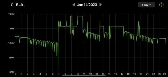

@MSimpsonNJ When the car is charging, it will charge with 14.8 Volt. Normally my car will not go beneath around 12.5 Volt, before it starts charging the 12 volt battery. Examples of battery monitor of my car in this video:

Interesting and thanks. I just noticed also that the SOC of the 12v is only at 68%. Wonder if I have a bad battery...
And following up - I charged the main battery overnight with my level 2, and the SOC of the 12v only went up to 71%
It is possible that your battery may have been "damaged" by several past incidents of being dead. It may still charge up, but won't hold capacity as when it was new. However, when the dealer does their battery check it may still show OK. Take it to a battery shop and let them test it (for free). They usually have better equipment than a dealer. If they find it defective I would push for a battery replacement.
I actually went through that scenario with my Solterra. It sat in port for a long time due to that wheel recall and by the time I got it was 8 months after manufacture. It ran dead on me a couple times. I charged it up at home, and it would reach "full" pretty quickly. But after having ACC on for a very short time (a few minutes) would go dead again. I took it to the dealer and to my surprise it tested OK. I then had it tested at a local battery shop (Edmunds) and they said it was defective and not able to hold a charge for long, which is exactly what I was experiencing. I went back to the dealer and pushed for a replacement, telling them about the battery shop test. They then relented and agreed to replace it. It has been good ever since with the new battery.
