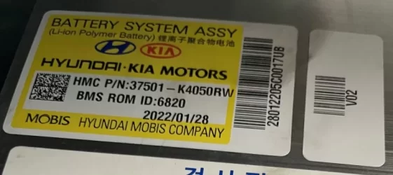

Chances are it's already been replaced. Have a look at the side of the car from a few yards back. If you can see the silver-colored aluminium sides of the battery hanging down it's probably new. You could also look at the yellow tag, left-rear corner. Mine and others have "RW" at the end of the part number. Plus, note the date.
Roger That and thank you. I noted silver-colored battery cover below vehicle, although I cannot spot the yellow sticker. A call to dealer also confirmed battery warranty replacement, and they were good enough to send me the repair records. Interesting that they report "while test driving after replacing the battery under campaign 200 there was a noise coming from the front end. contacted tech line, was advised to replace traction motor. After being replaced there was NO noise when decelerating." Nice to see there was a proactive mechanic on this case. It's surprising that Hyundai's Campaign 200 battery recall website does not reflect this updated information.
