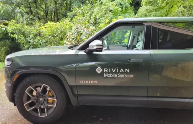

I think that we are going to see an on-going issue with companies, and particularly dealers, for whom EV's are secondary to ICE vehicles. My dealer has one guy who is the EV specialist. I had an AC issue last summer and had to wait over 2 weeks for an appointment because they wanted him on it. I have another EV from an EV only company (Rivian truck). Obviously, everyone there is an EV specialist. Coolest thing is they come to where I am since I'm about 70 miles from their service center. upload_2022-11-22_10-34-6.webp
