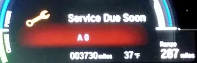

Lots of posters have reported A01 alerts; has anyone else seen an A0 alert?
Our Clarity just turned 1 and today the Mileage Minder decided it was time to assert itself. However, the MM didn't think we needed to rotate our tires after just 3,730 miles so it issued an A0 (oil) alert, not an A01 (oil and tire-rotation) alert.
I doubt the MM is smart enough to know I've changed the car's tires 3 times (summer/winter/summer/winter), which would eliminate the need for the tires to be rotated.
So if the MM is, indeed, grouping alerts to reduce service center visits, it's doing so on a oil-mileage-priority basis because the alert for our year-old (spanning a whopping 4 tankfuls of gas) oil didn't trigger a tire rotation alert. Honda knows owners who recently got their oil changed would not rush back to the service center to get their tires rotated when the A1 alert popped up days later.
While I don't mind having our year-old oil changed, I feel bad for people who actually go places in their Claritys. They have to experience the MM trigger an oil-change alert based mileage, not the engine's run-time.
It's interesting that while the MM is hogging the Driver Information Interface it takes care to re-position the car's remaining range off to the side. I guess it doesn't want you to become stranded while it's telling you to visit a Honda service center.
I'm thinking it's doing A0 because oil change every 7500 miles or 1 year, whichever comes first.

Yes, and as you and Electra said, I think the 'A0' came about only due to the 12 month anniversary, and tire rotation trigger is probably only based on miles since the last reset.
So as a (ridiculous) thought experiment, if you only drive 1000 miles in ten years it will still not ask you to rotate the tires, but it'll ask for 10 oil changes.
What I am saying is that people who drive more miles than you keep suppressing the "1" flag by rotating (or in my case swapping out the winter/summer tires) and resetting the MM tire rotation, then it will maybe wait a little longer to call for an oil change until you hit the 12 month or 7500 miles (is that mileage spelled out somewhere because I have never seen it mentioned outside of Electra's message above). And I think your observation does fit that scenario, but only because in your case you haven't run enough miles to trigger the '1'.
