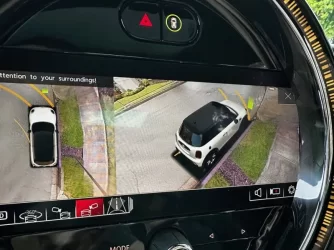

There are a few downsides. Most annoyingly, the cameras are not HDR so they can get blinded more easily than the factory camera. While the UI looks touchable, it is only iDrive controllable. Some of the automatic triggers (like parking sensors) are only as good as the sensors - and we all know MINI parking sensors are constantly pinging and beeping at even the smallest pebble some times. All very minor for the utility it adds.
Compared to other systems it's on par with a ~2018 OEM 360° camera despite what you might think of an aliexpress solution. 2022 Chevy Bolt was better all around, Polestar 2 has better HDR but a slightly worse stitching and back up camera.

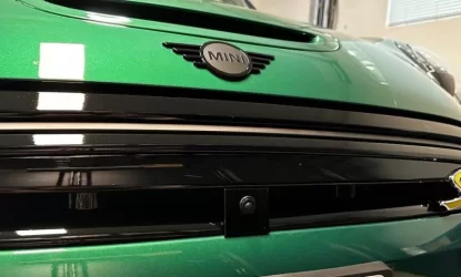

  5. Mounting front camera
    • A bit of preference here, but I chose the slot above the front license plate mount.The included mount works - if you remove the bumper and screw it in from behind.
    • Flush minded with the bumper would be cool, but the angle just isn’t right. You want ~10-20° tilted towards the ground.
    • I created a 3D printed holder that is friction fit with a little VHB for backup, installable without removing any of the front. Just print, route the wire, stick in place. I used color matched touch up spray paint to make it look a little more finished.

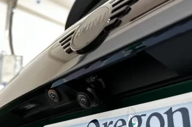

  7. Mounting rear camera
    • Remove the 3rd brake light cover by pulling to release the clips.
    • Remove the side covers by removing the screw that holds the parcel shelf string, then pulling to release the single clip.
    • Remove the interior hatch panel by removing the 2 center screws and pulling with some force to release the 8 clips.
    • Find a suitable place to mount, I chose to the right of the OEM camera, in the tailgate release. You may need buy or fabricate an additional bracket to make your desired location work.
    • Placement should be nearer to center than not. 15”+ off the ground and angled downward.
    • Screw, tape, or otherwise affix the camera and route the wire into the hatch.

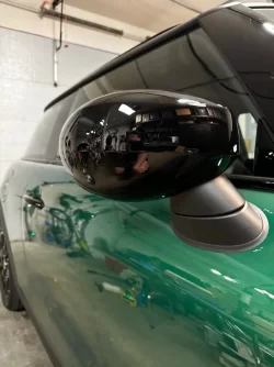

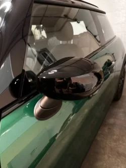

  9. Mounting side cameras
    • The cameras need to face downward and slightly back. If using the turret style, pick a place on both sides that works well. You can hot glue for temporary angle checking, but you have a lot of flexibility with these.
    • Check inside and out to make sure you will have clearance and not hit a clip or other structure.
    • Once you are sure it’s right, drill into the mirror cap. I learned the hard way - your OEM mirror caps are hard to replace. Measure 20 times, drill once, maybe even get a donor set to practice on.

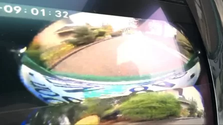

Does this setup allow for 360º dashcam/sentry mode recording? If so, any chance that you could provide a video sample?
Yes it does act as a surround dash cam. I only reviewed footage in car never pulled any samples. I un-installed the unit and sold my SE earlier in the week so can't grab any. I believe the video is 1280x720 per camera, recorded/viewed in the direct from camera fish eye, combined into a single 2x2 video grid totaling 2560x1440. Not great for pulling plates but gives a full play by play of any incident. Inside the UI it sorts video by day and 5-7 minute chunks. It has internal memory (I think it was 64Gb) and a USB-A that can be used to transfer files or record directly to it. I don't think it has much of a parking mode since it is tapping off the iDrive power and I doubt that remains active 24/7.
Best I got is a picture of a video on an ugly day. That is rear and right side.
