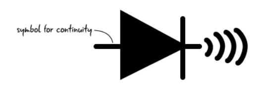

6) Grab your multimeter, connect the door button console to the bigger cable (so that the door lock/unlock button works). Put multimeter into continuity mode
And measure continuity between the 2 big sockets:
It does not matter which one is negative which one is positive. You should have continuity.
