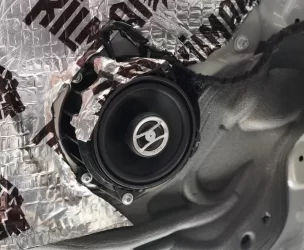

The Focals are a big improvement to the sound quality. I saw this video on youtube and it gave me the confidence to FIY it. I didn't have the adapter brackets. I was able to use two of the original holes and then drilled another one to mount it (I only used 3 of the 4 mounts on the speaker). I also added some sound deadening material to fill in the gaps.
After installing them, I set the "Fade" setting in "Tone" to more of the front so the sound in the back speakers are not as loud as the fronts. I might get to the back someday but I'm not sure it's worth all the work.

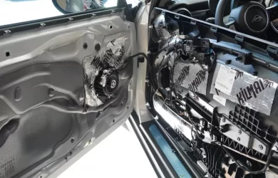

I had some sound deadening mat left over from a previous project and I put them to use in my SE. Looks like I only used two screws to secure the speaker to the mount. One to the original mount and another that I had to drill. ( I used the supplied screw tab from Focal) I then use some mats to seal off some gaps.
I found that Mini only applied sound deadening material to a small area of the metal door; maybe 8"x10". (sorry I should have take a pic of it.) I pulled some of the gray mat off from the bottom and added about 4X more of it. The plastic side was easier to apply the material. I covered most of the flat surfaces as you can see.

How easy is it to pry off the door panels? I’ve had some cars where they pop off easily and go back perfectly, while others whose clips were permanently damaged even with the most careful removal possible.
It was tough getting the first fastener clip to release. Once the first one popped off, all the others came off pretty easily. I used a plastic pry tool give me some space to slip my gloved hand to put at the bottom corner.
