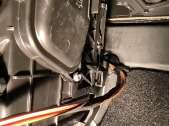

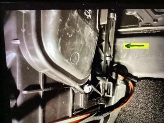

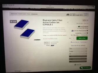

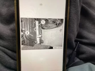

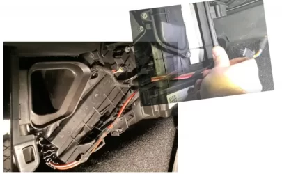

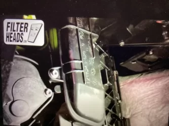

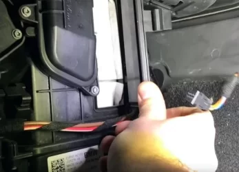

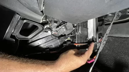

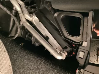

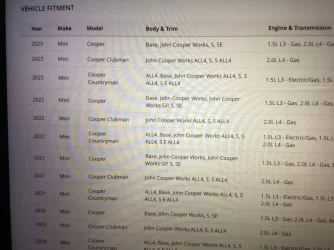

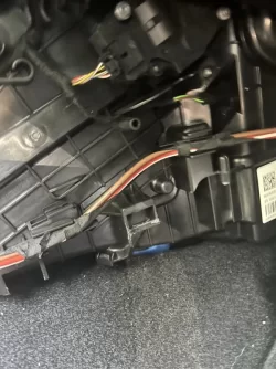

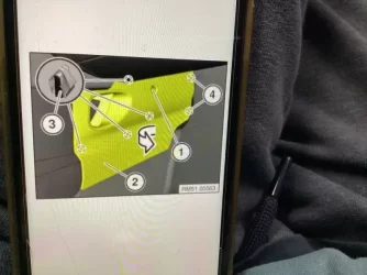

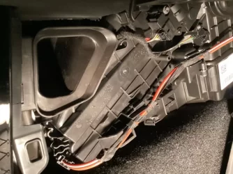

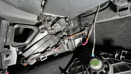

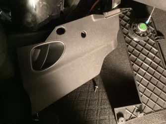

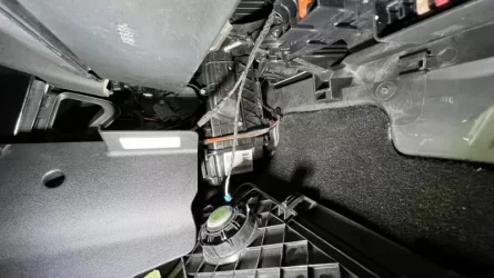

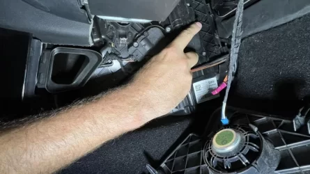

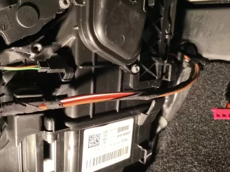

I have a 2022 Cooper SE. I was skeptical after so much back and forth, but it is in the same place as the F56. The one thing that is different is that you have to remove the plate under the glove box before you remove the side panel. That is two simple T20 screws on the two front edges. Once that is down, the side comes off easily. I would recommend disconnecting the light wire once the panel is off to make it easier to get into the filter. Unclip the door and pull the filters out and pop the new ones in. I did have some difficulties getting the filters out, but some needle nose plyers made it pretty easy. I ordered PureFlow filters and it came with instructions on where it was and the steps to replace it. I would recommend them, but don't get the air freshener with it because it will not fit.
Also for the record, I'm 6'3" and 250, and I was able to fit down there and get this done. ;)
Attached are my pictures:
