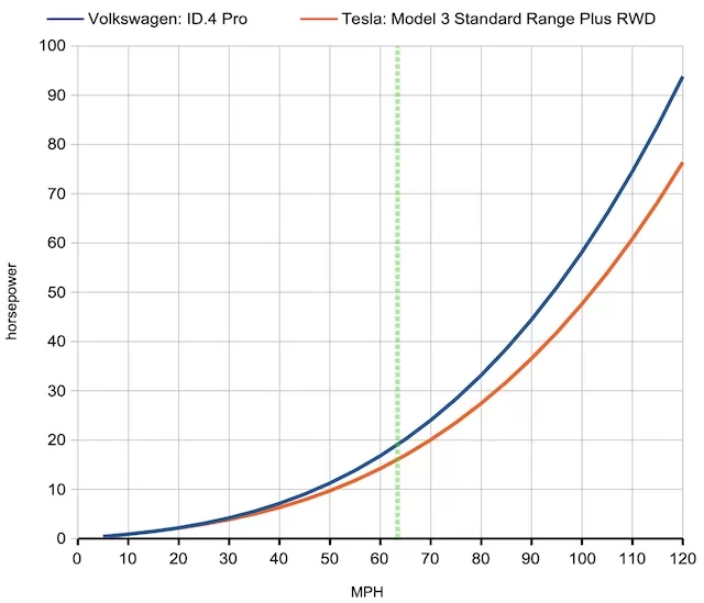

The key EPA metric are the roll-down coefficients to calculate the drag power:
drag HP = v * (A + (B*v) + (C*(v*v))) / 375
v - speed in MPH
A - drag force at any speed built-in to the vehicle
B - drag force proportional to rolling speed
C - drag force proportional to aerodynamic speed
1/375 - scaling factor to derive HP (746 W)

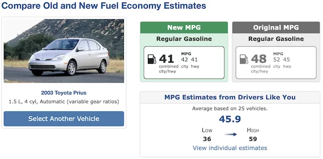

Given a choice between EPA metrics and an opinion, I prefer engineering. The EPA has made at least two changes since 2005 including our 2003 Prius:
v - speed in MPH
Note:
- drag force - (A + (B*v) + (C*(v*v))
- drag HP/kW power - v * (A + (B*v) + (C*(v*v))) * K_1
- drag energy Wh - (v*v) (A + (B*v) + (C*(v*v))) * K_2
