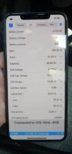

It works! At least the displays, haven't tested ABRP on iOS yet. So long android. I have a Vgate iCar Pro, works with bimmercode for me.
Just got this working with a Vgate iCar Pro Bluetooth 4.0 OBD2 scanner.
Looks like the app has changed names to "BiMi". Also, the ABRP interface to get a token is much simpler, but there are some steps. Not sure if the steps below from memory are 100% accurate, but hopefully will help.
1) Create an ABRP account (with email/password)
2) Under "Settings->Car model", you'll need to select "Mini Cooper Se (beta)"
3) Under "Settings->Car model->Add my car" (under the Mini Cooper Se (beta) setting you added earlier), add a car and name it
4) When you add a car above, it will give you options to link it to an app to get live data. One of the options should be mi3 (or maybe it was the new name BiMi?).
5) Generate a token to link with mi3/BiMi.
6) Follow the directions earlier in this thread to store this token in mi3/BiMi app and enable linkage.
Should basically work then. I confirmed I saw correct SOC in ABRP at least.
