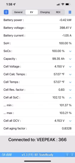

I got my new ODB2 adapter so decided to download mi3 for iPhone as that seemed the obvious choice but I was wondering if there were any others on iOS?
I guess I can use this to keep an eye on battery health over time.
I wish it would log time/date and State of Charge and Temperature to a CSV file so I could import it into my telemetry overlay software.
Is anyone aware of an app for iPhone that does this?
I wish it would log time/date and State of Charge and Temperature to a CSV file so I could import it into my telemetry overlay software. Is anyone aware of an app for iPhone that does this?
Car Scanner ELM OBD2 for iOS/Android will log data displayed on screen (Data Recording - .csv export)
you should select connection profile Mini Cooper or BMW i3
