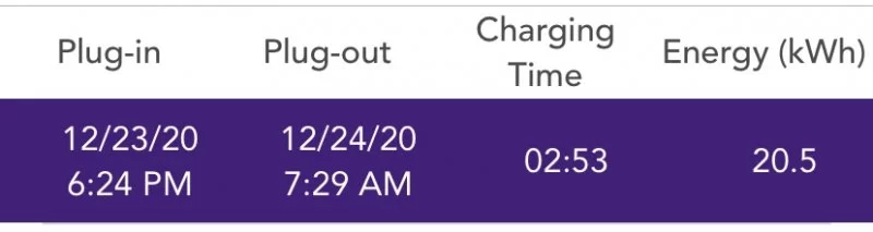

I had left it charging overnight to 90%. It had 88% this morning when I checked after the EV error.
The bulk of charging happened from 6:24pm to 8:17pm last night with 20.5 kWh added. The rest of the night had a small vampire drain.

I had left it charging overnight to 90%. It had 88% this morning when I checked after the EV error. ... The rest of the night had a small vampire drain.
If it charged to the limit at 90% and you had 88% in the morning (which could mean between 88.00 to 88.99%) then that's a whole lot more than a "vampire drain". That sounds more like cell leakage, exactly what the software is intended to catch. Also, any drains are tabulated by the BMS using the current shunt while leakage is not.

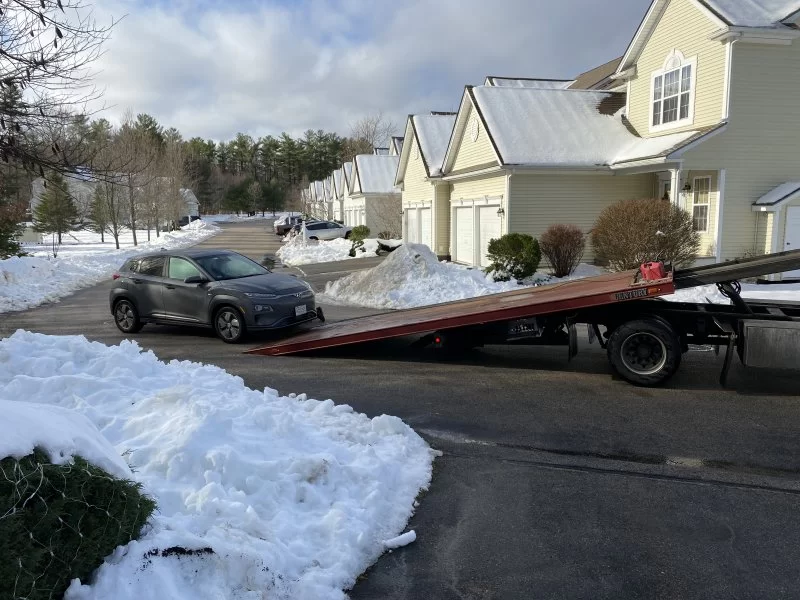

Any consolation, your Kona electric looks GOOD being loaded onto the flatbed. Have you noticed the battery saver light coming on post the updates? I have had one since,but it started.
