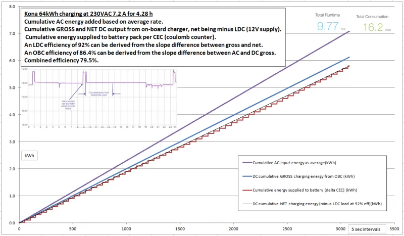

I did a test a few months back using a TP-Link energy-measuring plug adapter thing that I verified against another AC wattmeter. Accuracy is important of course. From that I get a total kWh value for the session. At the upper-right of the image I have the session total energy and time. The Torque Pro logging stopped unexpectedly after a shorter period, 4.28 h, so I had to assume a constant power input and just factor it.
The DC power output of the OBC can be determined from OBD data for pack voltage and amps, or alternatively another PIDs contain the product of those, labeled as "000_Battery Power". Integrate that power over time for cumulative energy. The dash readout appears to reflect this power value.
The DC input energy that the battery pack takes on can be determined by the change in OBD data CEC (cumulative energy charged) but the resolution is only 0.1 kWh so you need to charge up quite a bit to minimise that error. Note the steps in the red line.
I also pre-charged the 12V battery in Utility mode before the test to remove that source of error, shown in the small unreadable 12V system graph.
So, in this graph I have cumulative energy at each major point in the system, AC in on top, then OBC out in blue, and the red jiggle is CEC going into the battery after the LDC takes it share, about 0.2 kW.
To determine an LDC efficiency I have to assume that the only loads on the OBC are the LDC and the battery pack so I can deduce what the LDC draws. I assumed an efficiency value to produce the black line then adjusted that to match the black with the red line, ending up with 92% in the end.
Overall charging efficiency is about 79.5%, not terrible but not to be ignored either.
The last thing is that the overall efficiency of AC charging varies a lot by the amps that you're charging at and I have only one option at home, 230VAC 8A which turns out to be only 7.2 amps. The OBC could be up to 91% efficient at higher current and that 0.2 kW a smaller portion, both reasons to charge at high rates. But I doubt you could reach 90% overall.
