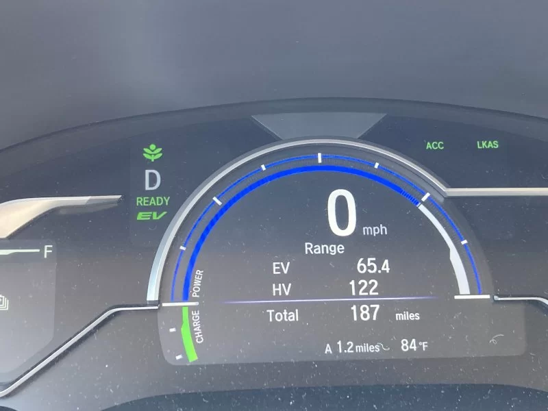

On a recent trip back from a hike, there was about 9 miles of downhill driving, and to my surprise, not only did that charge the Clarity beyond the supposed 47 miles of EV range, it went up to 65.4 miles!
In practice, this might mean that the car is learning and thinks it will get that range for a mix of downhill and flat road driving. It would be a good test to see how much range I might actually get on a long flat highway, but most roads around me are hilly.
What's the maximum people have seen their EV range show up as?

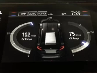

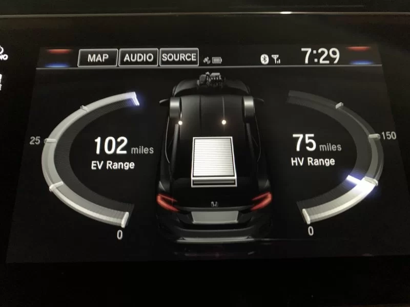

Yes. After a long downhill drive with the battery charge down about 3 bars, the estimate showed ~80. The range at the summit may have been ~42. An overnight charge brought it up to 102. Of course, actual range the following day was mid-40’s.
This my best so far.
And that’s just driving around a town that’s flat as a pancake.

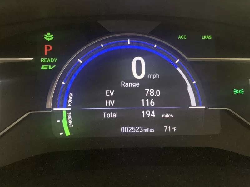

What is the highest actual EV range that you have achieved?
A little over 60 miles. I usually recharge when I get down to around half so I don’t get to measure total EV range very often. But the estimated range I’m given is pretty close to actual. I watch the odometer go up as the range goes down and they pretty much stay synched.
I have no doubt that I could get 78 miles on a 70 degree day driving conservatively without the air on and driving generally 45 mph or less.
