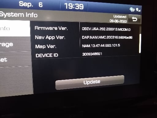

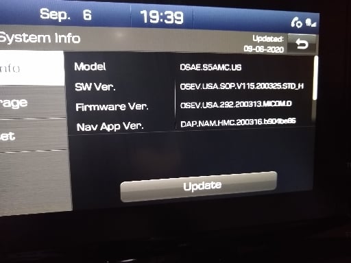

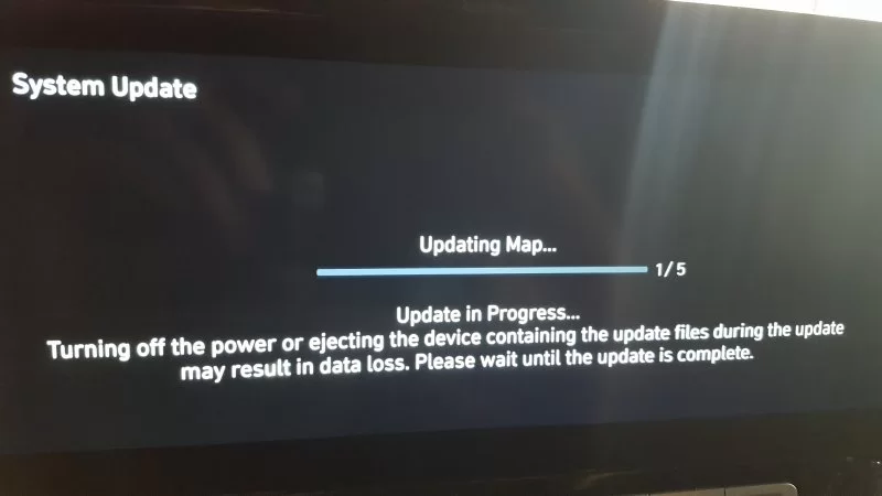

So I attempted to run the latest MAP update and it just seems to hang on pass 1 of 5 .. Pic attached. I've tried this 2 times now - each time letting the process run for over 2 hours with the car in the "ON" position.
Anyone else see this? If you ran the update, how long did you let it run?

OK, this is bazaar and the response from the MAP peeps is equally strange. They are telling me that we MUST used a 64GB USB drive for this update. (I had used a 512GB USB drive - assuming bigger is better! The LAST update I did I used a 128GB drive - and it updated just fine). Anyway, this has now hosed my Mulitmedia Screen. It is just spinning away on the "Update in Process 1/5" ... I have removed the USB drive (after HOURS of letting it run). I've turned the car OFF. They are supposed to get back to me as soon as they have some technical guidance for me ... In the meantime, be careful out there with the NEW update procedure. YMMV

Does the 20 model multimedia unit have a reset button? Also could try disconnecting the 12 V negative lead from the battery for a few minutes.
Just to be on the safe side I would try the old 128GB stick since you know it worked. Make sure to format it correctly. It has to be formatted with ext32 according to their website install instructions.

As mentioned in the post before, try the reset and apply the update again.

Thanks for all the suggestions. I just went to check status of the "hanging 1 of 5" issue .. After idling overnight (car Turned OFF), it finally stopped. I am definitely still at the old version of the MAP version - which is FINE btw. At least it's all working again. But I am now gun shy about these updates. I need to buy a 64GB USB Drive for future updates. Crazy that they suggest a 512GB USB DRIVE "won't work" ... but whatever...

As Electriceddy pointed out, the 2020 MY now uses a USB Drive ... there is no longer an SD slot. My only beef with all this is that the MapnSoft process "recommends" a 64GB USB drive.. Note "recommends" ... they should be more specific if it's going to FAIL and say "REQUIRES". I was thinking that anything larger than 64GB should work fine ... but alas, it created a nightmare for me... I was just glad it worked itself out and at least gave me back my Multimedia screen. Otherwise I would have had to visit the dealership. I ordered a 64GB USB drive from ebay and am waiting arrival to try this mess again.
Update: After getting a 64GB USB Drive and retrying this exercise, it in fact WORKED !! So lesson learned -- make sure to use a 64GB card.
