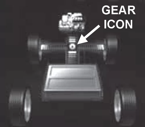

Do you really mean "gear mode" as in the gear icon appearing between the wheels:
I've never seen our Clarity stay in gear mode as you've described. Accelerating up a hill will take our Clarity out of "gear mode," as will allowing the speed to dip below 42 mph.

You don't seem to be using the phrase "gear mode" in the same way others on this forum understand it. I believe that when you hit the big SF hills, your Clarity's engine started up. Then you turned off your Clarity to get the engine to stop running. Before you pulled over and turned off your Clarity, you likely heard the engine running at what sounded like high RPMs, which doesn't happen in "gear mode."
"Gear mode" is something that happens only in HV (which I personally maintain stands for "Hybrid Vehicle").

Let me start with "gear mode". There are 3 "power source" modes in the Clarity. I'm using Honda's terms from page 14 of the 2019 manual:
1) Electric (EV) -- electric motor driving the wheels, with the electricity coming solely from the battery.
2) Hybrid -- electric motor driving the wheels, with the electricity coming from the battery and/or the engine (used as a generator). This is almost always the mode that you get when you accelerate hard, hear angry or busy bees depending on your perspective, etc. I strongly believe this is the mode you're talking about, and recommend you just call it Hybrid, engine running, EV off, or anything, but not "gear mode" because that's confusing people.
3) Engine -- engine is coupled directly to the wheels. This is what people here call "gear mode" (because it's "indicated by the gear icon" per the manual). This only happens at certain higher speed ranges under steady highway speeds. When coupled like this, there's only one gear ratio, so you'd never get particularly high revs in this mode (unless you were driving 150 MPH, which A. isn't possible in this car, and B. probably wouldn't result in gear mode anyway :-)
Important not to confuse "Hybrid" here with the "HV" switch where you ask the car to try to hold a charge level (which will result in a mix of all of the above driving modes).
3) Engine -- engine is coupled directly to the wheels. This is what people here call "gear mode" (because it's "indicated by the gear icon" per the manual). This only happens at certain higher speed ranges under steady highway speeds. When coupled like this, there's only one gear ratio, so you'd never get particularly high revs in this mode (unless you were driving 150 MPH, which A. isn't possible in this car, and B. probably wouldn't result in gear mode anyway :)
