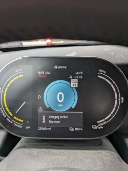

My car is possessed by electrical gremlins!
No, it's not -40F out in So CA.
And as of this p.m. both my windows refuse to roll down. I had this issue w/ a bad switch in my eGolf, but only on the driver's side. I could get it to work if I lifted the switch repeatedly (5x or so).

The next day my windows worked again. Of course, I'm taking it in tomorrow. I first took it in 5 months ago in Jan bc my charging flap sensor thinks the flap is open. They told me the sensor is due in tomorrow, after I called Friday.
Update: I woke up this a.m. w the thought that a rodent had chewed my wiring, which would explain the electrical gremlins. Had this happen to my wife's 2 month old Toyota.
Drive in and mentioned it to the service rep. He said, if it were, the result would affect the driveability of the car.
Got a call later and a rodent had chewed the temp sensor wire, which they think was causing the window issue, too. New temp sensor wire harness is due tomorrow, and cost to install + part is $500.
