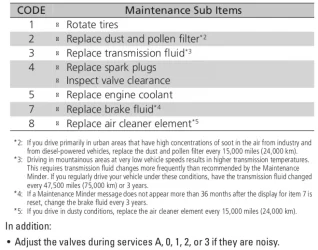

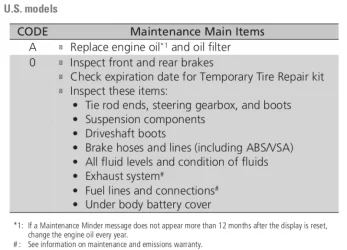

My maintenance minder came up today with an A01237. I consulted the manual and found out the '7' means 'CVT transmission'. Is that the flush? I'll be going on Tuesday.
What manual did you consult?
3 = Transmission Fluid
7 = Brake Fluid
Most likely the shop will just drain and fill the transmission fluid.
Finally I got the maintenance done. To my relief, the service advisor had co consult a "cheat sheet" on his phone to figure out what A01237 was, so I no longer feel like an ignoramus. Driving back home I noticed the engine and the "tire pressure" lights coming on. I was about to turn around and back to the shop when I remembered people in the forum saying warning lights could light after the 12V battery was disconnected. Drove home, turned off the car, then back on and the lights no longer appeared. So far so good. Now I have to take it back for the recall, once they call me when they get the part.
