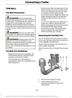

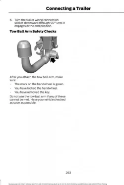

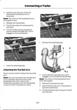

The Euro manual even seems to show that The Mach-E comes with its own hitch and tow-ball from the factory...
