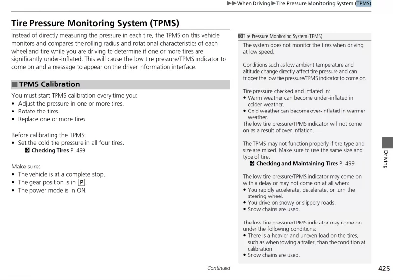

Are you using a tire pressure gauge to check your tire pressures? It is possible it is reading off. There is a calibration procedure you can follow as well in the full owner's manual, page 425.

"Tire Pressure Monitoring System (TPMS) - Instead of directly measuring the pressure in each tire, the TPMS on this vehicle monitors and compares the rolling radius and rotational characteristics of each wheel and tire while you are driving to determine if one or more tires are significantly under-inflated." {Anyone know what the sensor is? Is this TPMS sensor even in the tires?}

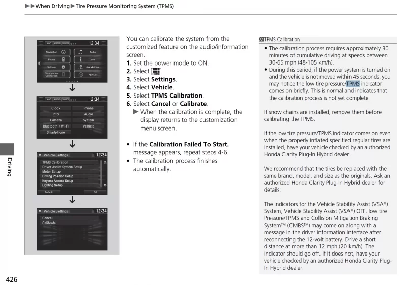

So, I did some TPMS owner's manual reading too. Our system is a bit odd. Not only does it not read tire pressure in the cockpit (the Volt displayed all 4 tire pressures), but it only looks at differences between the readings. If I read the instructions correctly (still learning), any time you top them off or change pressure, you must do a TPMS system cal.

Tiralc, that’s exactly how I interpreted it. It’s bizarre that you have to recalibrate the system once you add or subtract air.

We had this problem with a new Clarity at the start of our cross country trip. The warning came on despite even tire pressure in all four wheels, but the problem went away after recalibrating and traveling to warmer climes.
Now we are about to go back up into cold country and i am wondering if the low pressure light will come back on. Will know in a few days.
We had the warning early on and also yet all tires were at the appropriate tire pressure. It took 2 recalibration cycles to get things right.
