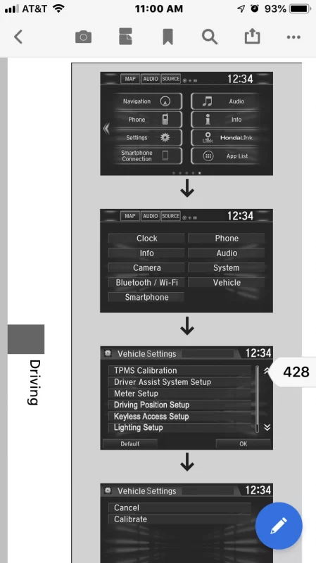

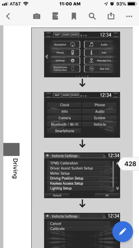

Here you are.
From the manual p 425ff.

You can calibrate the system from the customized feature on the audio/information screen.
1.Set the power mode to ON.
2.Select.
3.Select Settings.
4.Select Vehicle.
5.Select TPMS Calibration.
6.Select Cancel or Calibrate.
When the calibration is complete, the display returns to the customization menu screen.
