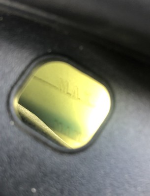

Although you did not mention this, it is fairly difficult to check this level. They put the darned tank in an area that is quite inaccessible. According to the manual, you look through a "window" to see the min/max level markings on the plastic tank. This "window" is maybe 1" x 1", and is viewed from the top, under the hood. I found it impossible to see the level through this window without shining a trouble light through the grill in front to illuminate the tank. it was tricky to get this right in order to 'see' the fluid. I was looking through the window while maneuvering the light in front until it was clear that light was illuminating the bluish fluid. In order to be sure, I wound up jostling the car so I could actually see the fluid slosh a little.
I presume you experienced a similar thing? Having seen this, I need to ask the dumb question as to whether you are certain you really saw an 'empty' tank? I could see how you could easily be deceived by this crummy arrangement ! Do you park in a garage? If you did have a leak, it would likely have resulted in a visible puddle along the way...

No... Take a look in-person when you get a chance. The viewing "window" is really closer to 1/2" x 1/2".
There is NO access to a fill-cap at all - it is totally inaccessible without disassembling a large plastic cover that goes over the whole front portion, connecting to the grill, and the air filter duct. This plastic piece is held in place with the plastic pop-fasteners. I took a few out just to explore and the cover was not coming loose. I broke one and then declared defeat since I really have no reason to go there right now. Seems like a poor design, and it could have been made intentionally inaccessible if they had good reason to prevent the owners from dealing with whatever this coolant is.
Just checked mine for first time ever out of curiosity. Indeed looking at tank thru the car’s grille it looks deceptively empty. But looking thru the little inspection window up top and shaking the car? Fluid can be seen sloshing at a visible high level and it is obvious the empty-looking tank is actually nearly full of fluid. As Mr Fixit says, it is not especially easy to check, but once you find the inspection point it takes 5 seconds to see it’s ok.

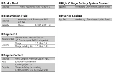

The coolant is specified in the manual as Honda Long Life Antifreeze/Coolant Type 2, mixed 50/50 with distilled water. Same as the engine coolant.
Not sure I agree with this... It is the same basic coolant, but here in the specs (page 567), it looks like the HV and Inverter coolant systems use the Type 2 undiluted, while the engine uses the 50/50 mix.
On page 492, where the inverter cooling system is covered, it says the coolant is a 50/50 mixture. Perhaps it is a 50/50 mix in the bottle. I haven’t seen the packaging. This would mean there is nothing to do but pour it in.
Page 490 is somewhat ambiguous to me. It specifically states that the engine coolant is 50/50 in the side bar.
Yes, the inverter and HV is [kind of] in the same section, but...
I would defer to the spec's on page 567 which seem clear that the engine is 50/50, and the inverter / HV is 100%

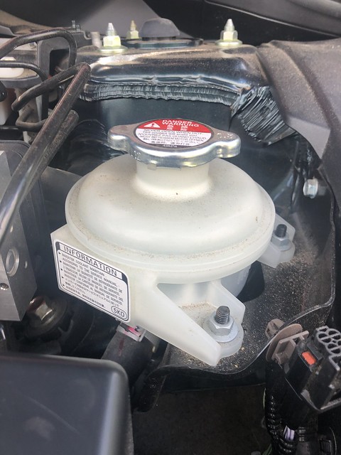

I had no idea there was a separate coolant thank for the battery coolant.
I was only aware of this one, but apparently that’s just for the inverter coolant:
Just found the other one, and mine looks OK:
That's with a bright flashlight shining through the grill.

I had noticed the same regarding the third coolant tank level, and made mention of it during a subsequent PM service. Honda's service advisor informed me that (allegedly) the coolant level has to be observed while meeting certain conditions (e.g., 15 minutes after engine shut-off, etc.) in order for the visual check to be representative and accurate, and that otherwise the systemic distribution of the gross coolant accounts for the seemingly deficient volume. I have no idea how much of this explanation is actually authentic, nor why none of this was mentioned in any of the vehicle documentation.
Having kept an eye on the coolant tank in question through the "eye hole"...I never noticed it change regardless of when it was checked. The Clarity I drive displayed a level below the "max" line but slightly above the "low" line every single time it was checked...before a drive, after a drive, 2 hours after a drive etc.etc.etc.
Suffice it to say...today, when I added some coolant to the tank clearly visible inside the engine bay (overflow tank I'm guessing)...the level of the coolant tank visible through the eye hole now reads to "max" fill line.
