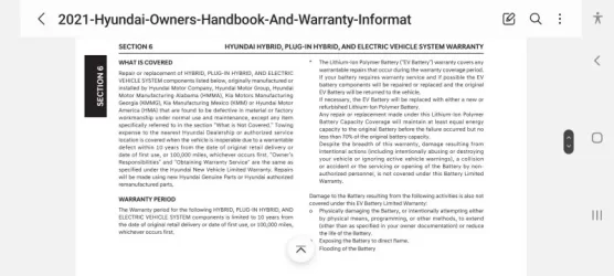

I dug in and to me it looks like the power train warranty is for ICE cars, not EV. the warranty info above, EVS warranty, for EVs PHEV and hybrid does not have any original owner language.
You can look this up (Applies to USA models) here to verify warranty duration.
I filled in 2021 SEL Kona EV, and you will notice (in fine print) on page 15 that the powertrain warranty is indeed 10 years/100,00 miles for the original owner, subsequent owner(s) 5 years/60,000 miles, so this is not something you want to drag your feet on;)
I meant to attach this. I really hope I'm right!!

I've now read it a few times (I'm in US) and it reads to me like the the battery itself is under a 10 year 100k warranty. The powertrain would be 5 years, but I'm not even really sure what that means with this car.
Just my interpretation, but if the problem is in the motor, that would be covered under the "Hybrid, Plug-in Hybrid, and Electric Vehicle System" portion which covers "Traction motor, including housing case"
Anything else in the driveline would be under the Powertrain portion; Case and all internal parts (read: gears, bearings), axles, CV joints, hub bearings. This would include the gears and bearings between the motor output shaft and the splines where the axles connect.
In either case, you have at least 5 years/60K miles allowance which you are definitely inside of. I would avoid driving it until the problem is identified - god forbid you have a chipped gear tooth and it decides to grenade itself on the highway or something.
