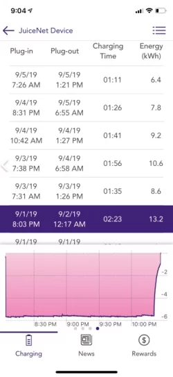

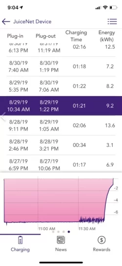

8BFF5192-71BE-4E97-8351-269D2953A266.webp FC716E0F-7B79-43D9-A213-18C273DE085F.webp I’ve had this same issue with 220 charging once with a low quality charger... so I upgraded to JuiceBox40
Here is what I’ve learned.. if I set the max rate to 32 amps, it WILL make these noises and on the graph show erratic charging, but if I set the max rate to 24 amps, absolutely no noise and smooth charging graph.
I have know idea why it is happening but it seems to be that the higher amps make it happen.
If you look at the two graphs, one is at 24 and the other is at 32... big difference normally occurs at the end of a charge in my experience. I’ve seen no I’ll effects as of yet but I definitely cringe when I hear that sound.
I just leave my JuiceBox set to 24 amps and that eliminates the “issue”

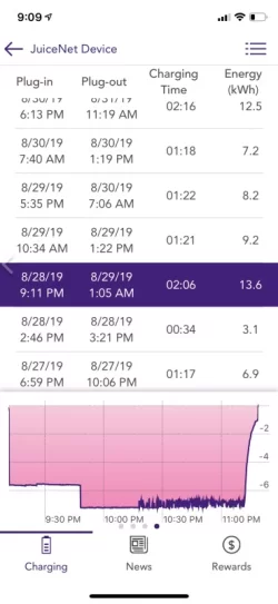

BA6F515B-2C63-461F-88F9-9DC305520081.webp One more example, I had the juice box set to 24 but for whatever reason said “I think I will try going back to 32amps”
You see the graph at 24 to start and the “drop” is actually the increase to 32 amps, and immediately following you see the “up and down” irregularities that correlate to the dreaded noise from the rear
