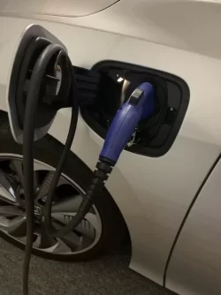

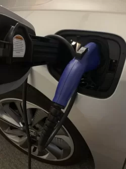

I haven’t had the problem, but I have recently begun a practice to potentially avoid the problem in the future. Rather than allowing the weight of the plug and cable to just “hang” from the port, we gently route the cable, from the tail of the plug, up and over the curved “water deflector” on the charge lid, and then let the cable hang to the ground from the lid.

Here are 2 options. Over the lid door hinge would work for larger cables. Also, as with any plug that is connected and disconnected repeatedly, it is important to make it as delicate an operation as possible, each and every time.
