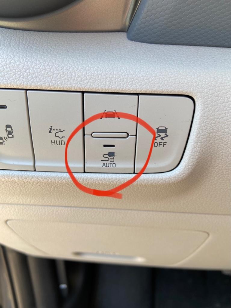

Two questions:
1. There used to be a setting that allowed you to remove the charging cable once the car was fully charged without having to unlock doors. I cannot seem to find that in any of the menus for the new user interface. Can anyone point me to the location?

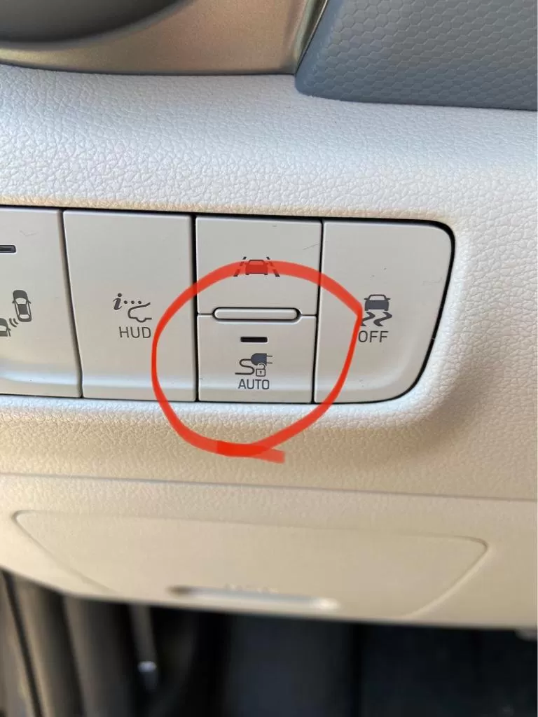

I believe your answer for Question 1 is on the lower panel controls by your left knee.

The light is off indicating the connector will remain locked to the vehicle after charging is completed, to prevent someone stealing your cord as they use in Europe, here the cord is tethered to the EVSE so no need to lock after completion. With the light on (illuminated blue), the connector can be removed after charging is complete without having to unlock the doors. There was nothing ever in the media software that would do this function, only provided with the switch.
