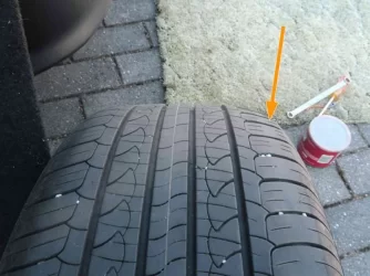

Anyway, today I finally set to and did the all-around rotate + brake caliper
cleaning/refresh routine, to make sure the slide-pins were in good condition
and the pads would slide reasonably freely. As I pulled the rear wheels off
to cross-move them to the front, I took a hard look at their tread blocks, and
finally understood what was likely going on. It took this many miles to get
to the point of being really noticeable, since I run all four around 60 PSI
anyways and that, plus my general driving technique, always makes any typical
wear take a lot longer for me to manifest.
[ higher-res link: http://techno-fandom.org/~hobbit/cars/ev/76rearwear.jpg ]
The Kona comes by default with quite a bit of negative camber in the rears.
Just viewing the car from a ways behind it makes that fairly obvious. For
what reason, I cannot imagine; it's not like anyone is taking Konas out
to Track Day, so why does it get factory-set as if it would be subject to
frequent hard cornering? The inner sides of both long-time rear tires were
clearly feathered a bit, and that's likely what was causing the noise into
the cabin. Those are on the fronts as drives now, which have essentially no
camber either way, so that should slowly work to fix them. Meanwhile, a
short test run already returns that the newly-placed rears run quieter.
This *will* be load-dependent, as the camber adjusting bolts inboard of the
rear suspension members are at different offsets from the car's centerline.
If only one of each rear wheel's pair is adjusted, that will also affect toe,
so to *only* adjust camber, both bolt spacers per side would have to be
moved the same distance. Since it's taken this long with no rotation for me
to notice any effects at all, I'm not going to eff with it. I'm to the point
that I should probably get all new feet for this beast anyways, but the three
crappy factory Nexens + one oddball-replacement still have enough handily
legit tread depth so I can probably hold off longer. Yes, after 40k+ miles.
I don't thrash them...

Many EV owners run their tyres at higher-than-spec settings, but 60psi, probably 66psi when warm, is way higher than the recommended 36psi.
However that over-inflation would lead to uneven wear in the middle of the tread, not the edges.
I would think the rear negative camber is to reduce oversteer if you accidently hit a sharp curve too fast.
And explains why the tyres need rotating so often.
Heh, well, in my case it certainly wasn't "so often", and now we can see the result.
That was true for non-radial tires. I ran my Gen1 Honda Insights at 60psi for ~150K miles with very uniform tire wear.
With the Kona I'm no longer obsessed with efficiency and wife prefers a softer ride so I keep them ~40psi.
Having done more driving around today, notably to hit my usual Batteries Plus for a 12V
they said they had in stock, I now think I hear the "wooba-wooba" effect more from the
front, and even feel it through the wheel at certain speed ranges. And more prominently
during regen braking, which is probably the most stress on those tires as they're now on
the front. They may never "equalize" back out by the time they're simply done, but at
least I know what was going on.

I can also notice the tire vibration now from the front quite a bit more on a *wet* road.
