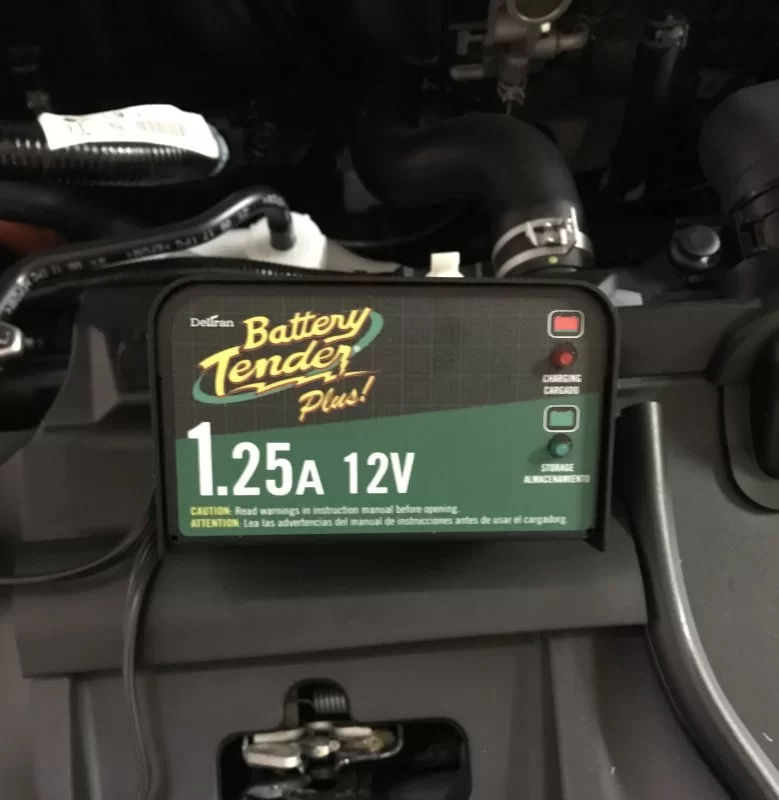

IMHO, the best battery maintainer is a Deltran Battery Tender Plus. A perennial favorite that that always gets good reviews and has been around a long time. Very heavy duty with an all metal case, UL listed, and serialized. I’d steer clear of the cheap Chinese knock-offs.

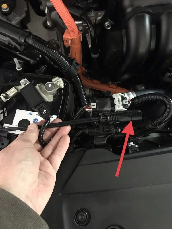

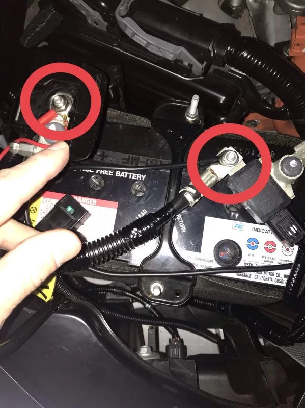

If you’re going to store the Clarity more than once or twice, it’s a real time saver to attach a quick connect plug to the battery. It’s a quick and easy install and costs less than $5. Then you just plug in the polarized plug. I’ve got one on the riding lawnmower and one on my Clarity. Makes it a breeze and no worries about the clamps hitting the hood.
The quick connect is installed in just a few minutes since it has lugs that fit the accessory bolts on the + and - terminals and stores out of the way.
Here’s the posts you use. I’m holding the cover of the + terminal open
Here’s where the end neatly stores until needed
And here’s what you want. All metal and no cheap plastic. It comes w clamps and is ready to accept the quick connect also made by Deltran.

I’m more in the “buy once cry once” camp myself. If I’m going to attach a battery-minder to a $30,000+ techno-marvel of a car, I’m not about to quibble over 20 or 30 bucks. Not knocking other companies, but the Deltran is arguably the best battery minder in a crowded market. Ask any gearhead car collector or RVer.

I would like to purchase one of these units, and was surprised to find that Deltran has so many choices:
http://products.batterytender.com/Chargers/
The one in your picture looks like it could be their legacy product. They also have a "brick" style that seems virtually identical:
http://products.batterytender.com/Chargers/Battery-Tender-Plus-High-Efficiency.html
No real discernable difference in the performance numbers, and essentially the same price on Amazon, etc...
The only thing I see that tips the scales is the fact that the 'legacy' metal chassis unit has a 10 year warranty vs. 5 years for the 'brick'.
Do you think the 'brick' may fall into the cheap Chinese knock-offs category (even though branded as Deltran)?

I don’t know for sure. It’s certainly getting harder and harder to find quality products these days. It seems every mfg is going cheaper and cheaper and this is probably being driven by the fact that most people shop just on price and not on quality.
Mine is most definitely a legacy model since I bought it earlier this year from HD who was discontinuing it. Got a great price on a dusty package. I’m old school and like the heft of a metal unit.
I’d say the longer 10 yr warranty speaks well to the quality issue. Have you tried eBay for a new, old stock item?
I didn't mean to imply that the 'Legacy' unit was not available. It seems to be a current product too.
Easy to find on Amazon, etc. It's just odd that they are still producing both (for essentially the same price, around $44).
Maybe the metal style will be phased out, but not yet.
