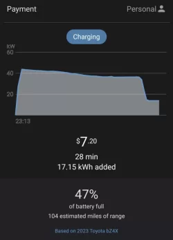

The most recent time this happened, it suddenly dropped from ~37kw to ~15kw at 47% charge.

The screenshot as from the last time it happened. The ambient temperature was a it above 40F. It was on a 350kw ChargePoint charger and no one else was there.
We have had this happen on EVgo, ChargePoint, Electrify America, and at a local Nissan dealership. I have logs and screenshots.
