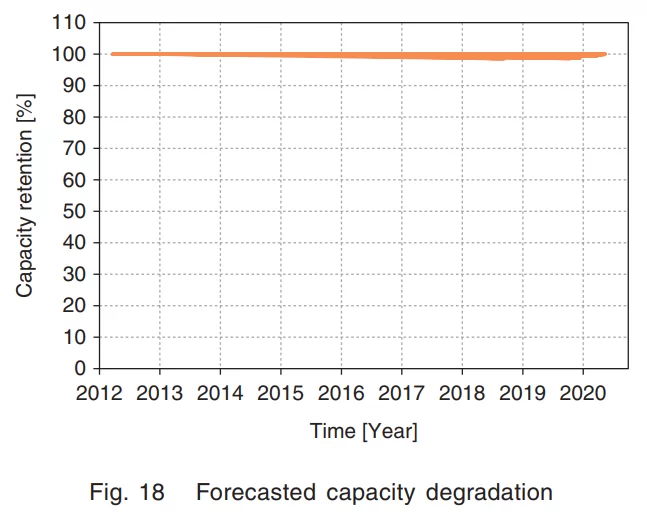

Another really good paper from Honda on EV battery lifetime, based on the usage data from the Honda Fit EV.
https://www.hondarandd.jp/point.php?pid=1203&lang=en
There is a reassuring graph of capacity retention forecasting that doesn't move much off of 100% after 8 years. Probably optimistic!
