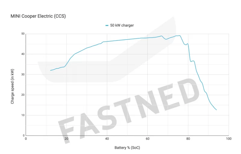

How long charging takes depends how much charge your battery has when you begin your charging session. This graph illustrates how charging slows down when you get closer to a full charge:
