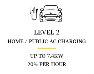

The CHARGE tab on MINI USA website page for the MINI Cooper SE claims the car will charge at up to 7.4 kW:
I believe the Owners Manual refers to the 16-Amp Level 2 charging cable that comes with the car in the UK. The final one-sentence paragraph on page 218 of the Owners Manual refers to a charging cable permanently attached to a Level 2 EVSE. No reviewer has encountered a 3.3 kW limit (and I've read many, many reviews). It may be a problem with the EVSEs you've tried. Does your MINI dealer or a friend have an EVSE that you can count on to deliver 7.4 kW?

Yeah, you guys are right. The strange thing is, the "settings charge current" option that shows up when I turn off the car, or go to My mini --> vehicle settings, only lets me adjust the 120V current. To adjust 240V current, I have to press "Menu" then select "plan charging" then "settings charging current" from the drop down. Seems like it should have the same options as the other two but for some reason it doesn't.
