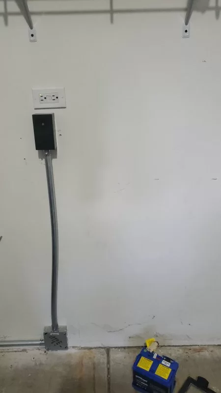

I have 2 220 volt outlets in my garage and have 2 EVs (2018 Clarity Plug in and 2012 Leaf). When I got my garage wired I asked the electrician to run 2 separate 50 amp lines to future proof for 2 EVs. I currently use a GE wattstation for the Honda and charge the leaf on the 120 Volt. I just got a really good deal on a Chargepoint home hard wire which I bought.
I have 2 options, 1 is to hardwire the EVSE. For that I will have to unplug the receptacle and connect some kind of a whip conduit to the evse: https://www.homedepot.com/p/Southwire-3 ... 373118-_-N
Second option is to get a 50 amp plug with 6 or 8 gauge cable and connect it to the ChargePoint: https://www.homedepot.com/p/Eaton-50-Am ... /206405351
Issue with option 2 is it covers the only 110 volt outlet in the garage due to the cable. Picture here: https://photos.app.goo.gl/toKbwdaR6JMXeKxr8
How hard will it be for me to open the box, cut the cables and then connect the whip conduit to the EVSE. That seems to be the best option. Electricians want $200 t move the receptacle 2 feet!

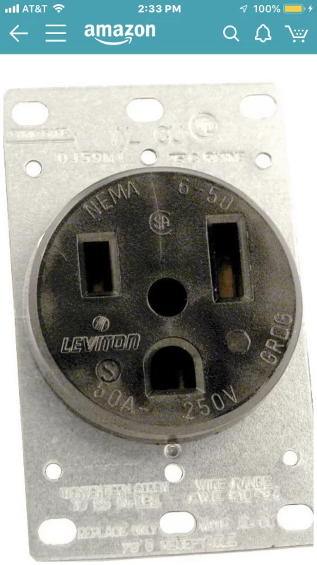

You don't need the “whip cable”. ChargePoint makes a plug with short cable just for the ChargePoint. It installs in the spring lock terminals just like a hard wired install would. This is much preferred over adding extra length by splicing in with wire nuts.
Since the ChargePoint does not require a neutral, it uses a NEMA 6-50 receptacle. If your outlet is not a 6-50, it can easily be converted and the neutral wire safely capped with a wire nut.
I am not a licensed electrician, but I strongly recommend you go this route.
If you are a mechanically inclined DIYer like me, you can install it your self. If your receptacle is already a 6-50, all you do is open the ChargePoint, insert the prestripped wire ends into the spring lock terminals and push the locking tabs closed. Then you just plug into the receptacle. Changing out the receptacle to a 6-50 is easy too, but if you’ve never done wiring before you might be better off calling for an electrician. Just pay him or her their 1 hour service call. For me in KY, that was only $70. The NEMA 6-50 receptacle is around $13 on Amazon if you need it.
Here is a picture of the NEMA 6-50 receptacle that matches the ChargePoint plug. It’s basically the two hot legs and the ground and is rated to 50 Amps.
I really can't tell from the pic but it looks like the black box is sealed with a cover plate. The wires inside (hot or not) should be capped. One simply has to remove the cover and caps and properly connect the wire leads from the EVSE to it (if provided or buy your own wiring). My hardwire ClipperCreek unit came with both the wiring lead and wiring instructions.
Here's one possibility to retain the 120V outlet access and hardwire the Chargepoint. I assume the 240V outlet is the one with the conduit running up the wall to the single receptacle. The conduit is likely 3/4 inch, which works fine for the Chargepoint. 1) Turn off the power, 2) make sure the power is off 3) remove the 240V receptacle, 4) pull the conduit off the wire and cut about a foot off the conduit 5) put the conduit back on the wire 6) install the Chargepoint on the wall and attach the conduit 7) wire the Chargepoint with the instructions in the box. 8) turn on the power. I can't see the type of receptacle you have already in the photo, but if it's 4 wires, then like @KentuckyKen noted above, don't use the neutral with the Chargepoint. If any of this is uncomfortable for you or you are not certain how to turn off the power, then the $200 for the electrician to move the outlet is the way to go! One last note: why do you charge the Leaf with 120V if you have 2 240V in your garage?

One option I have is to open the square box at the bottom and run the whip conduit to the chargepoint. All I will have to do is cut the wires that go to the receptacle and then use connectors to connect to the new conduit.

Fotomoto: The black box you see is a 6-50 receptacle.
Sandroad: I thought about what you said but that wouldnt work because the height of the chargepoint would be too low. I only had 1 level 2 charger and the leaf gets driven only 15 miles a day so L1 to 80% takes 4 hours.
Did you think about moving 110 volt outlet couple of feet up or side? This may be little easier by using old work single gang box and cover it with wall plate.

I wonder if there is enough slack in the box to just rotate the 6-50 receptacle 180 degrees in the same box? (breaker OFF, use care not to damage insulation, or push insulation into a sharp edge, if unsure, do not try this yourself.) Also, If you do this, double check all the connections are still tight on the outlet after rotating it.
Otherwise, it should be relatively easy job for an electrician to shorten or lengthen the horizontal conduit, so the box riser is either left or right of the 120V outlet. They might need to go enough left or right to hit a stud. Does that allow enough room for where you can mount the chargepoint? Some of the bolts for the chargepoint, either for a plywood backer or the unit itself should go into a stud too.
Maybe what makes the most sense is get an electrician in to both move the receptacle and to mount the chargepoint EVSE for you. Hardwiring is not horrible, and not that difficult, and looks fine. It is just a bit more of a pain if you need to change out the unit later.
Oh, I see you mentioned the $200, but maybe in the long run, just do it and get it done. You are going to spend $50+ no matter what, so more like $150. That's a good chunk of change for me too, but sometimes it just makes more sense to get a pro to do it for you.

So I bought a 6-50 plug and some 6/3 cable and plugged the chargepoint in. That works, however it covers my only 110 volt so I need to improvise.
I was thinking the same thing, depending on which ways the wires are going it seems like either the 120 or the 240 could possibly be moved. But I think that is probably back to being a permit issue even if no wiring is changed. Then again if the work is done neatly who would ever know that the outlet was moved, but I'm just saying I wouldn't be surprised if you called the city and asked if you need a permit to move an outlet a few inches higher, they will probably say yes.
I’d just move the entire vertical section and junction box at the floor 16” to the left. To do this you need to disassemble it all starting at the receptical working backwards, eventually you shorten that conduit at the floor about 16”, re-fish the wire thru the vertical section and reinstall 16” to the left at the next stud. You need to buy nothing to do this...just a bit of labor. You will be shortening the wires inside by about 16” too before reinstalling he receptical.
As a handyman/electrician by trade I would charge about $100 to do this basically just a 1 hour service call with no materials. And I sure wouldn’t be messing with permits...this is a simple repair situation to an existing circuit.
If you’re a rudimentary DIY person, you can do this. Shut power off first and get the screws on that receptical TIGHT upon reinstall. #1 rookie mistake I repair is an outlet that a homeowner installed and then it went up in a puff of smoke after plugging in a hairdryer or space heater. Then they’re suddenly scared to do their own electrical work so they call me in to fix and advise. The mistake was simply undertightened screws....EVERY time.
>>Just remove the existing black receptical, install a junction box with removable cover in its place, run a 16”’ish piece of horizontal conduit to the right or left to get to the next stud with appropriate sized conductors inside, and reinstall the current black receptical on the next stud over. Interference problem solved.
That could work, but if the OP is qualified to do conduit work, why not just shorten the horizontal conduit and move it all to the left. Same for going right, but that needs a coupling and more conduit, and might need more wire.

if the OP is qualified to do conduit work, why not just shorten the horizontal conduit and move it all to the left. Same for going right, but that might need more wire.
Moving the outlet if done neatly (i.e. repair drywall, spackle and paint) will make the move essentially invisible to "prying eyes", whereas other options might draw attention at some future date. Maybe that would be unlikely to cause an issue, depending on the locality, again I am just pointing out an additional factor to consider if things will be done without a permit.
Shortening the conduit at the floor results in nothing but a couple screw holes to spackle. No drywall patch necessary. It’s all surface run.
