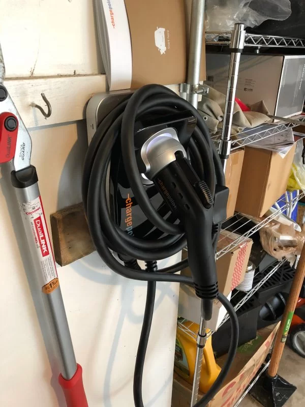

I am sure there are many very good brands out there that you should consider. I personally went for a plug-in Siemens VersiCharger (mounted in the garage, out of the weather, but with a 25'+ cord) such as offered by many big box stores like Costco, Lowes, etc. and ran the connecting cord to the car, sometimes inside, sometimes outside.
I didn't need or want the much more expensive WiFi enabled chargers as I figured the HondaLink app plus the 2/4/6/8 hour charge delay button on the charger would be all I need, and if I want it I can easily get other detailed electricity usage statistics from the utility via the web.
Finally, while you can save a little at the margin to go for a hard-wired charger, the Siemens plug-in comes with a slide-off mounting rail that means you can just take this whole unit with you in the trunk on a long trip if you want. Or, if you decide to move somewhere else, just unplug this one and move it to your new home instead (protect your investment by taking it with you instead of leaving it as an attached fixture). Or, if you have a lake house or something like that, you can buy an extra mounting rail and take the charger there. Costco recently had this one on sale for a final price under $400, and other retailers put these on sale from time to time too. (Or, if you qualify as a veteran, you can take 10% off the price at the register at Lowes or HD.)
