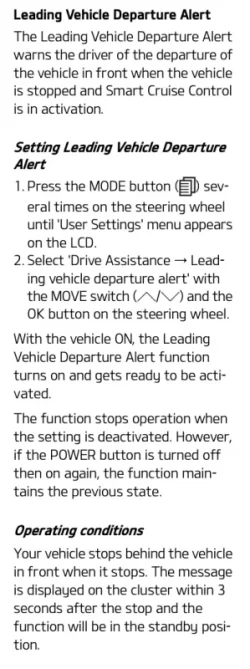

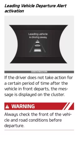

Screen Shot 2022-02-19 at 8.17.19 PM.webp Screen Shot 2022-02-19 at 8.16.40 PM.webp
I see that the manual says that Smart Cruise Control has to be on, but that makes no sense. If you have cruise control on you are zipping down the highway. No one is stopped. Cruise control cuts off below around 20 mph. Must be confusion on terminology.
Either way, my car "dings" when the car in front of me and I are both stopped and then that car pulls away. Makes sense. It is telling me, I might want to start moving.
