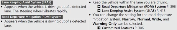

The attachment below discusses the Road Departure Mitigation (RDM) system which is what you may be referring to.
Hope this helps.
I do a lot of freeway driving and always encounter wide lanes and very narrow lanes. I've tried all 3 settings and can't tell the difference so I have it set to normal. What are these settings for?
You've been changing the settings of the Road Departure Mitigation System, not the Lane Keeping Assist System. This may be the same as @Clarity_Newbie's attachment, but I didn't open it.
