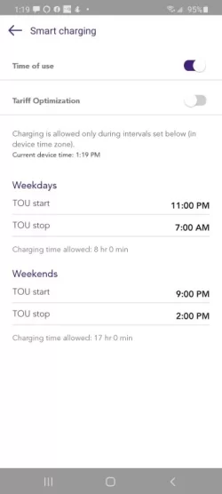

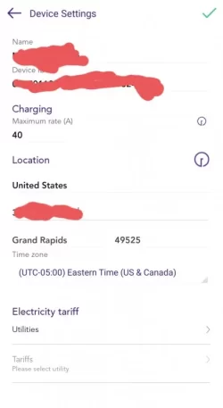

Juice Box 40 has the ability to regulate the amperage. I only use slower charge rate when its really hot here in Michigan.
Set amps to what you want. Amps x 240=charging watts20200525_131736.webp Screenshot_20200525-132000_EV JuiceNet.webp
