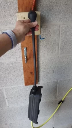

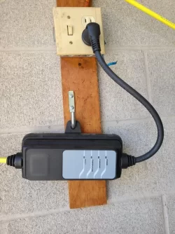

Hi Jamie, same thing happened to me twice. I tried plugged in a different outlet but not helping. Both times waiting for 5-10 minutes help. However, the second time I can duplicate the problem. Like Insightman said it could be a ground issue. In my case I suspect it has to do with the way the cable is manufactured.
1. The plug is installed a bit side way, so that when I hang the charger I have to twist the wire before I can plug it in.
2. The plug portion of the wire is thick and short, so it is not flexible enough to enable a smooth plug in. The "best" way will just let the thing hanging in the air, but ......
3. I noticed that the length of the prongs are a little bit shorter than normal.
Because of the above, I think the prongs of the plug and the receptacle will not always have a good connection. I have to re-configure the way I hang the charger.
I will see if it happens again.

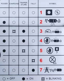

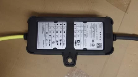

I need help on understanding what the lights mean.
I'll take a shot. I've condensed the LED status graphic and added numbers in red. I hope the clear diagram and numbers will make it easy for other, more knowledgeable, forum members to correct or elaborate on my interpretations.
1 - not plugged in
2 - plugged in and ready to charge
3 - charging speed limited by high temperature
4 - charging halted by high temperature
5 - charging halted by problem with power connection (eg. a faulty ground?)
6 - a failure so profound that LEDs are not sufficient to describe it
7 - the power is too wonky for charging to proceed (eg. from an unregulated generator?)

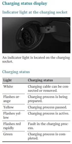

The LED on the charging port offers information, too:
