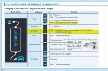

Have a head-scratcher of a problem here. We are in BC and were under that 'temperature dome' that has some insane heat over the past week (47 degrees Celsius) but things have mellowed now and are about 10 degrees Celsius cooler. Last week during the peak of the heat wave wife got an error message related to temp of car/battery too high to operate (sor something similar). This week we cannot get car to charge from the 12A setting on the stock charger when running from the house. We are getting the following on-screen (charger) error messages (manual excerpt attached below):
"-CHARGE - Blink : Charging In power saving mode, only the CHARGE indicator is illuminated."
"-PLUG - Blink : Plug high temperature warning."
Car is outside (no garage) and gets afternoon sun but it's never been an issue before (but it's also never been as hot as it was last week). Trying to eliminate any issues related to power supply from house, different plugs, different extension cord to charger, etc. (all of which has worked fine up until this past week) before calling dealer tomo. Anyone with Exp., here?
